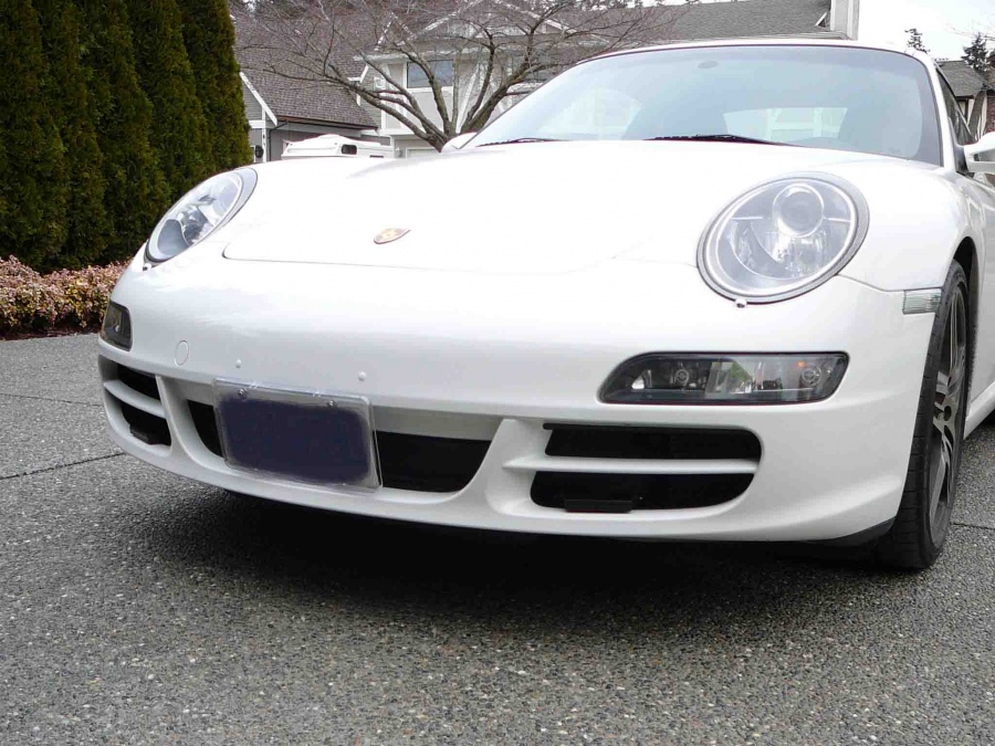

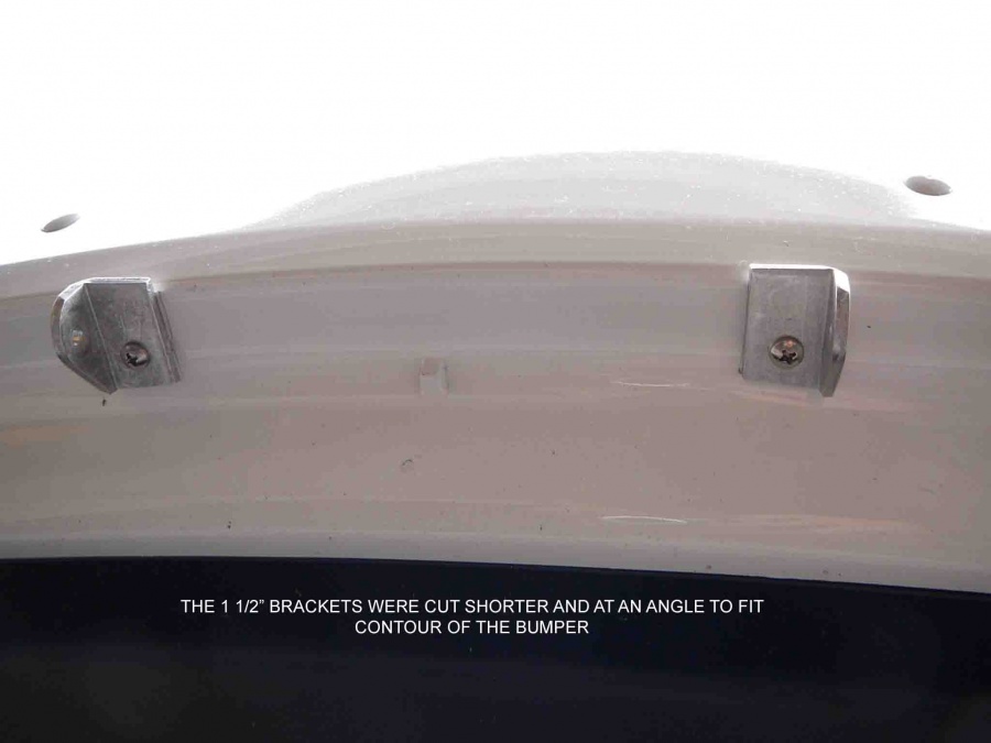

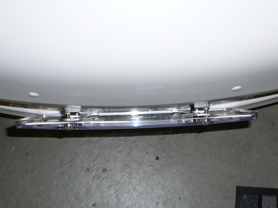

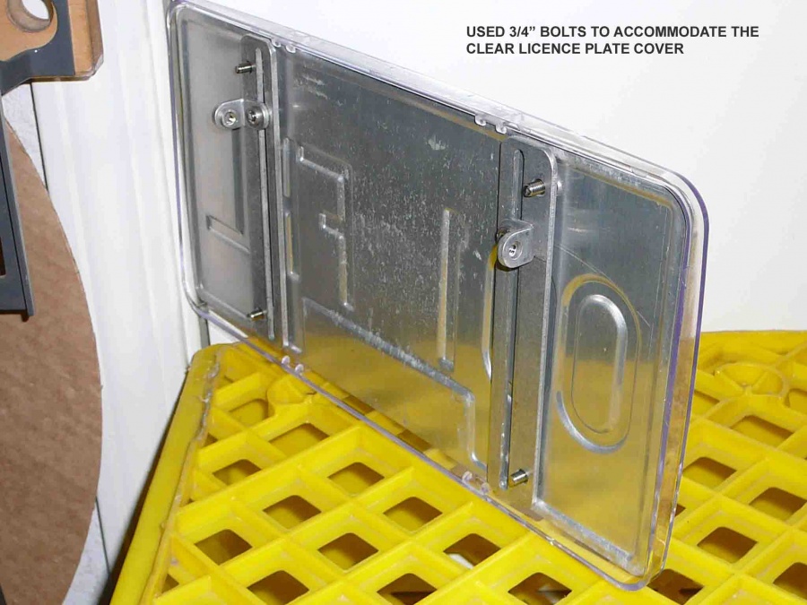

IT IS possible to install the Skene Design 1.5" short bracket onto my 2007 997. I just completed the installation with a slight modification. I cut the back end of the mounting bracket at an angle in order to mount on the underside of the bumper with less than 1/2" portruding out the front. To accommodate the clear plate cover, I bought 3/4" x 32 S/S bolts and cut them flush (going to do the bottom ones as I scraped my hand washing).
This arrangement looks a lot better than right on the face of the bumper, IMHO. PM me if anyone needs more details.

When I received the car, there were only 2 small holes about 1/8" diameter spaced 9" apart. Our license plate mounting holes have 7" C-C spacing. Also I wanted it mounted lower for better aesthetics (IMHO). Anyway, the 2 small mounting holes I had to drill are underneath and out of sight. Also the small screw hole caps painted to code are very unobtrusive (the tow hook cover cap is more unsightly).

When I received the car, there were only 2 small holes about 1/8" diameter spaced 9" apart. Our license plate mounting holes have 7" C-C spacing (look at the last pic in my earlier reply). Also I wanted it mounted lower and at an angle for better aesthetics (IMHO). Anyway, the 2 small mounting holes I had to drill are underneath and out of sight. Also the small screw hole caps painted to code are very unobtrusive (the tow hook cover cap is more unsightly).
