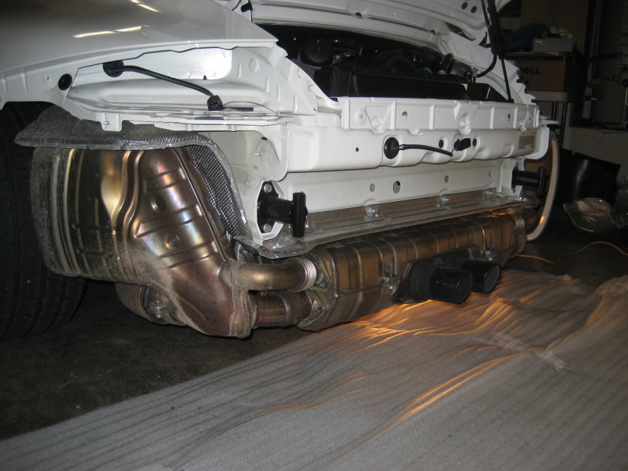

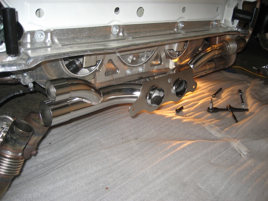

DIY Muffler Install for the 997
The following is a DIY Muffler Install for the 997. Very similar to the 996, but details might not be obvious or posted. Here I will key off what is known already about the 996, and will assume reasonable shade tree mechanic ability.
First, I refer to the fine threads:
Removal of the rear bumper cover and muffler:
http://www.renntech.org/forums/index...howtopic=16935
996 sport exhaust and bypass pipe install:
http://www.renntech.org/forums/index.php?s...p=6&#entry6
Here are some items to consider and watch out for:
1) Find a safe stable way to jack up the car with fail-safe in case of jack failure.
2) Remove rear wheels - it is alot easier to remove and install the mufflers with them off
3) Remove rear bumper cover - Remove rear tail lights to access a lone hidden torx screw and see 1 torx in wheel well, in addition to the other obvious screws under the engine lid and under the car - it is alot easier to remove and install the mufflers with the cover off
4) Remove heat shields to access the mufflers - see my pics below, the fasteners are very obvious
5) To remove and re-install new mufflers, follow the above threads......
6) I used WD-40 soak on muffler fasteners prior to removal and fused aluminum anti-seize compond to lube up muffler joints for install.
7) I found that a ratchet with a pivoting head and just the socket was more useful and easier than a ratchet a universal joint and extension and socket.
Here are some pictures which may help:
Torx behind tail light for bumper cover removal:
Torx in wheel well for bumper cover removal:
Exhaust shield that needs to be removed:
Exhaust shield after removal:

i just followed sharkwerks instructions. removing the resonator does not require removing the bumper as its a simple bolt on. but they bypass requires both sleeved ends to be attached to both muffler. at least one muffler has to swing out sideways in order to slide each sleeve of the bypass in place. with out removing the bumper, there was not enough room to install the bypass.
perhaps there is some special technique im not aware of?? perhaps the gt3 bypass install from sharkwerks is a bit different? anycase removal of the rear bumper was very fast like 15min. btw, i never took the wheels off or even jacked up the car.
