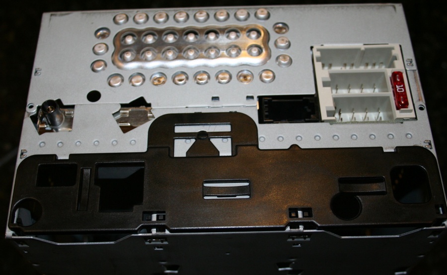

Bought an Ebay PCM 2.1. Install was quick. Powered right up and looking good. Went to dealer for code set up.
No sound. The PCM I bought does not have the small built in amp, it seems to be for a Bose car. My car is W/O Bose.
Any one have any insights for a solution?
Tech says adding a factory Amp is a very big $ deal. Lots of wiring harness work.
My new to me PCM maybe for sale rather quickly. I am bummed. It sure looks great.
Thanks for any possible solutions.
Pics below are of my CDR-24 unit. The PCM I have does not have these aluminum little round buttons. They are the heat sink for small amp.

check the part number on the PCM. I believe there are two part numbers, one for cars with bose and one for without. search for daytonaviolet's thread as he did some research into this when he was doing his retrofit

997.642.143.xx is the part number for BOSE cars
997.642.141.xx is the part number for NON-BOSE cars
Unfortunately, i do not believe there is an easy or cheap solution for this. selling and rebuying is probably the best way!
