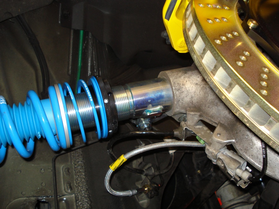

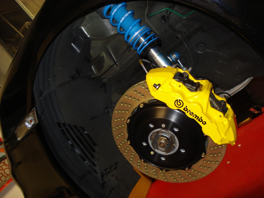

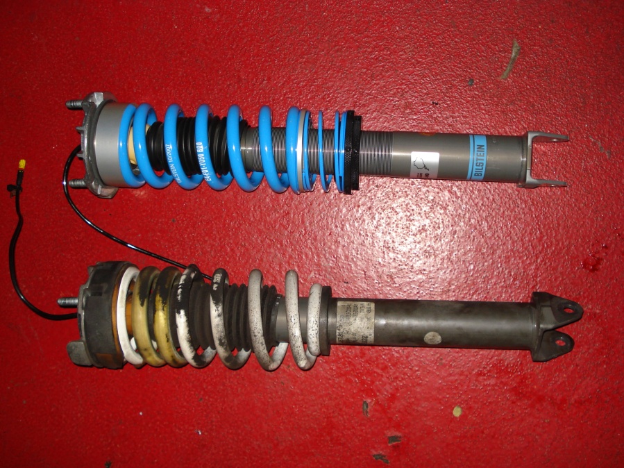

The Techart springs were great . It's just that the price plus installation isn't exactly cheap . The height is ideal --at least on the Turbo it was. 3/4 in lower , firm and planted but not uncomfortable . sport mode was a bit hard but not too bad .
The Bilsteins I like more because beyond the ability to dial in settings it has just enough flex to absorb the stress on the tires but not so much that the car feels floaty .
Pics -
Side by side -Techart spring next to Bilstein
Installation pics .
