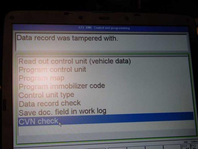

The answer is yes. PIWIS can detect if a ECU has been flashed, the number of times it has been flashed, and when it was last flashed, even if the programming is returned to stock.
This is absolutely not true. That is why several of the tuners that own the right equipment can claim that if they return to stock, there is absolutely zero chance of detection. Again, everyone has to do their own research and be comfortable.

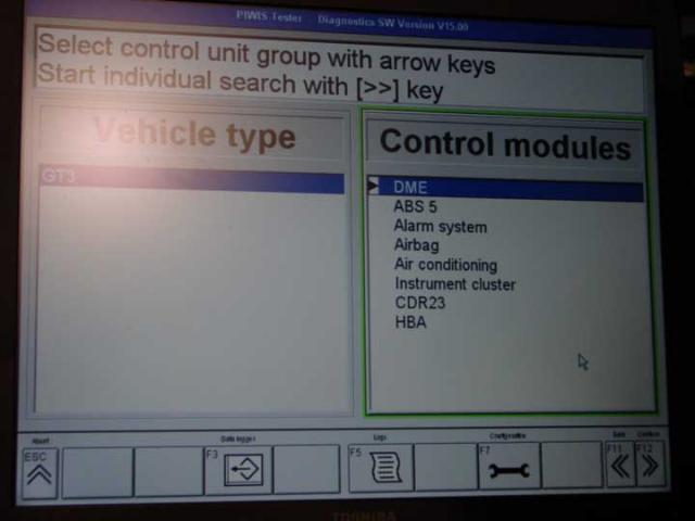

Are you speculating or do you have info? Here is my supporting evidence. DME readout of a tuned 04 GT3 using newer PIWIS...reflashed to "stock."

I've seen it in person on 07 997 products, zero evidence anything was ever changed, confirmed by using PIWIS. It all depends on how well you know your way around the equipment, hard coding, etc.
Remember, the car's computer is just like any other. It has memory in it and if you know what you are doing, you can truly wipe data and restore data to exactly how it "looked" before anything was changed.
One more time - everyone needs to be convinced themselves. If uneasy about any of this, best to not touch anything.
