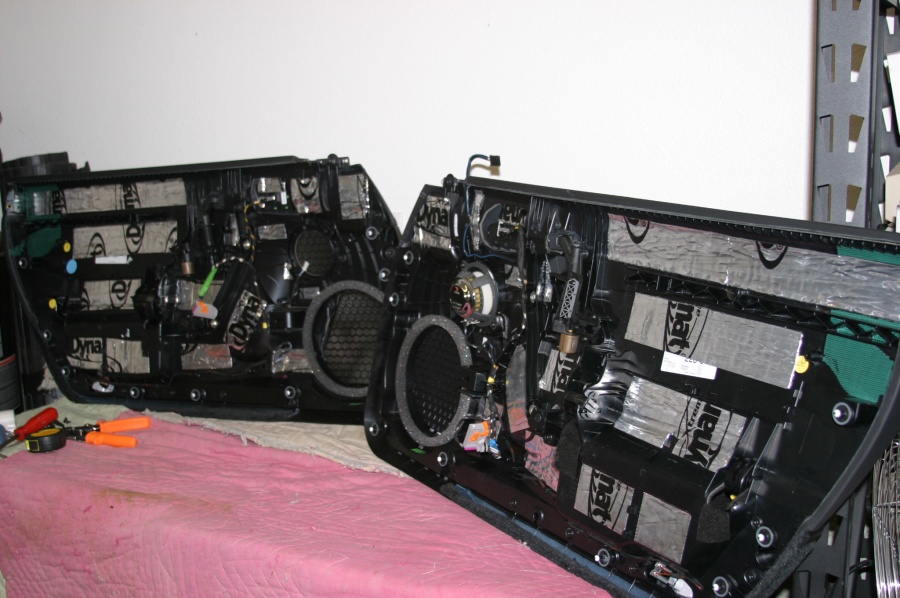

You guys are really cutting my work out for me here. If you're finding these posts useful, give me your rep points!
Here's the back of a CDR/PCM unit. Notice the dimpled aluminum backpiece which is the heatsink for the internal amp. If you have this, you have an internal amp and can drive your new amp off the speaker outputs - the red connector shown below. On my unit, I installed panel mount female RCA plugs on the black plastic backplate shown below, and ran some twisted pair cat5 wire from there and soldered it to the speaker out spades under the red connector:
Here is the full removal and install guide for a CDR/PCM on the Cayman Club/planetporsche.net forums:
http://www.planetporsche.net/reviews...ate=1219656811
That unit looks like your amplifier. Here's the description from your p/n:
http://www.pelicanparts.com/cgi-bin/...%20SOUND%20SYS
It almost looks like you have the room to stick the JL amp there.
I don't think any additional signal processing is necessary. The stock speakers are very cheap, but running a spectrum analysis show they play pretty flat and appear to be acoustically designed to match the car's door and interior. The tweeters appear to be a silk soft dome tweeter and seem to extend well to 20khz. They are designed to be super efficient and make the most sound out of as little watts as possible. Come to think of it, I don't think the amp in the head unit puts out more than 7 watts/ch. When I connected a regular speaker to it, I could barely hear any sound come out of it.

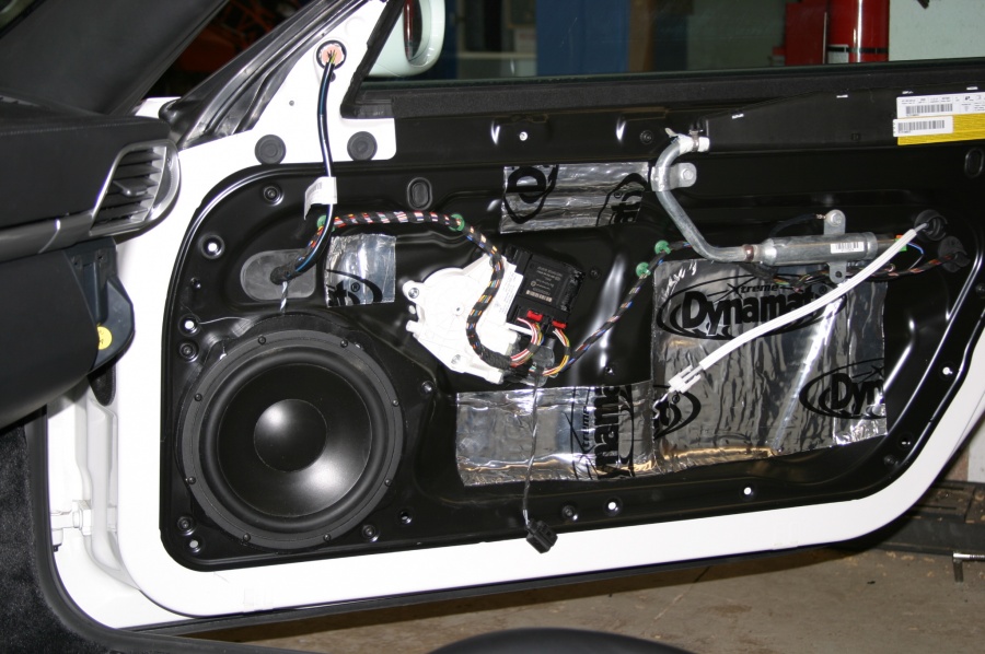

If you want to keep the car looking 100% stock, Morell 9" drivers will fit in the doors and we have been using Focal K2p's which fit into the OE locations remaining for the mid tweet. It's really important to sound deaden the door and the panels the result is amazing bass - it's really good, and no rattles.
While there are lots of amps that will interface with the OE head, Zapco's work really well hide nicely.
It all fits under plastic and you have 100% of your car.
I also deadened the rear of the car, wheel wells and panels and more and interior noise is much lower - and the car feels tighter - really nice. We have done this for 3 cars just recently and everyone really likes it. Adds about 20 pounds overall to the car.
