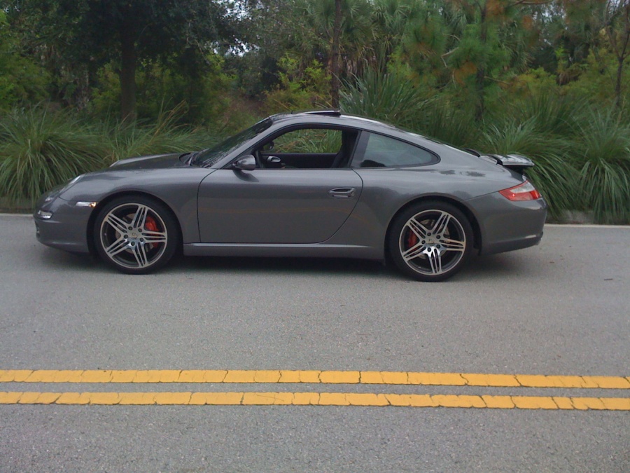

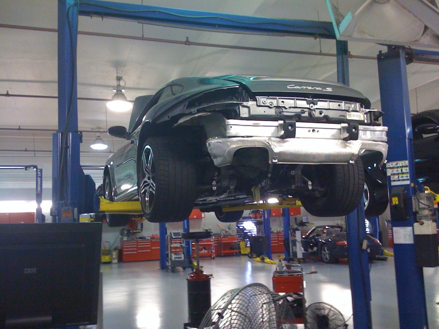

Pics
Two pics, one from today's visit to the dealership and one before the engine meltdown (and no, I don't drive around with the spoiler up , it was done for the picture). I did not realize that the entire bumper and side covers needed to be removed; I guess it's to clear the exhaust? I asked to see my old engine but it was gone already. I mentioned the clutch again and my SA assured me he would further investigate a potential cause other than the usual suspects so to speak...

What tire size are you running on the back? those are fat!
Good news on your engine! Please keep us updated!

Standard C2S set up...I know they look enormous in the picture, probably because the bumper is off.

305's I guess.... I have 305 but they don't look that big.... maybe I'm used to them! LOL!
The wider 305's are standard on C4S's (they have 8.5 inch rims), the C2S's (even with the turbo wheel option) like mine have 295's with 8 inch rims in the rear.
Actually they are 11" wide in the rear, the fronts are 8" with the turbos coming in at 8.5".
Dave
Correct, thanks for catching that...but the C4S fronts are also 8.5 just like the turbo, or so I thought?
