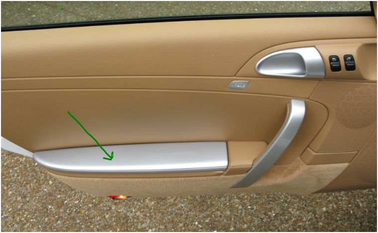

I would like to go back to the factory leather arm rest pad...can any of you give me instructions on how to properly remove these?

There is 5 T30 torx holding the door on: trim piece all the way toward the rear, leather trim between the two pieces you want to replace, just pry up on it, the small trim piece just to the front of the door pull, behind the door release handle (pop out the round piece) and under the mirror adjust switch (pop the bottom outward and slide it up). Gently pry the door off, its held in with plastic locking tabs. If you have one of those airbags that come with lock out kits they kick ***. Disconnect the release cable, unplug the connections. Once the door is out the pull handle is screwed in. The arm rest pad i believe comes out as and assembly. I'm sorry I can't recite from memory replacing that, sorry.
