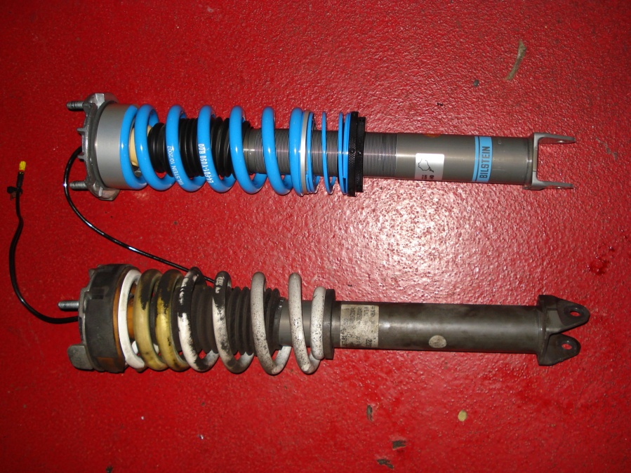

I had Techart springs on my Turbo . The labor time wold cost nearly the same as if you bought Bilsteins coil overs but the springs cost a lot less . As far as springs go the Techarts are great . They just aren't coil overs .
Here is a picture of what my spring looked like next to the Bilstein . Maybe this will help you see if you have the same.

Hey Thanks! But looking at your picture, it seems like the Bilstein also has a wire that can be reattached back to the car for PSM to work correctly?
Here's how I understand it. My car does not have PASM, but does have the "Sport" button. When I push that button in, the engine responses differently, and so does the shocks. It supposedly firms up for sportier handling. If I change my shocks to Bilstein, and assuming that it may not have the wire to adjust per the button, won't I lose the ability to use the "SPorts" function of the car?
Even if the Bilstein has the wire to hook it up, is it tuned similarly to stock?
