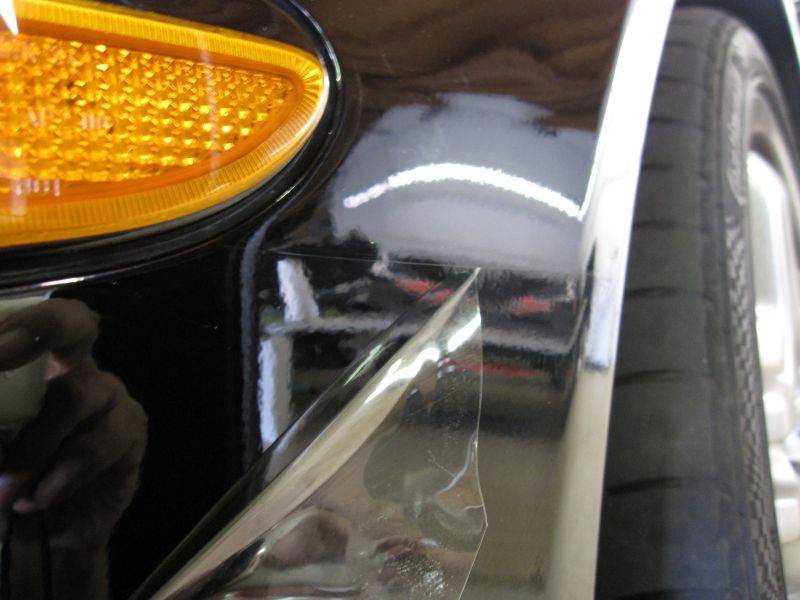

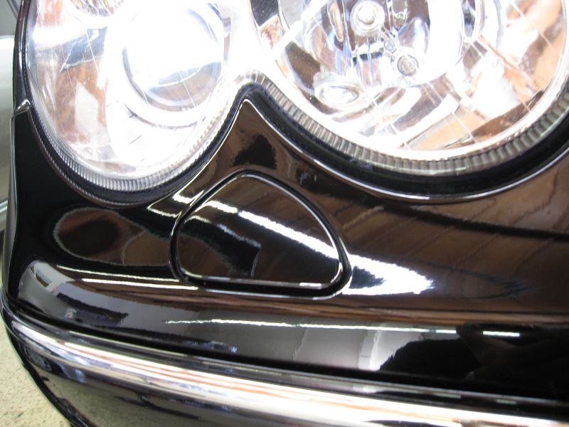

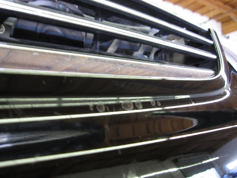

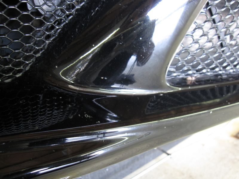

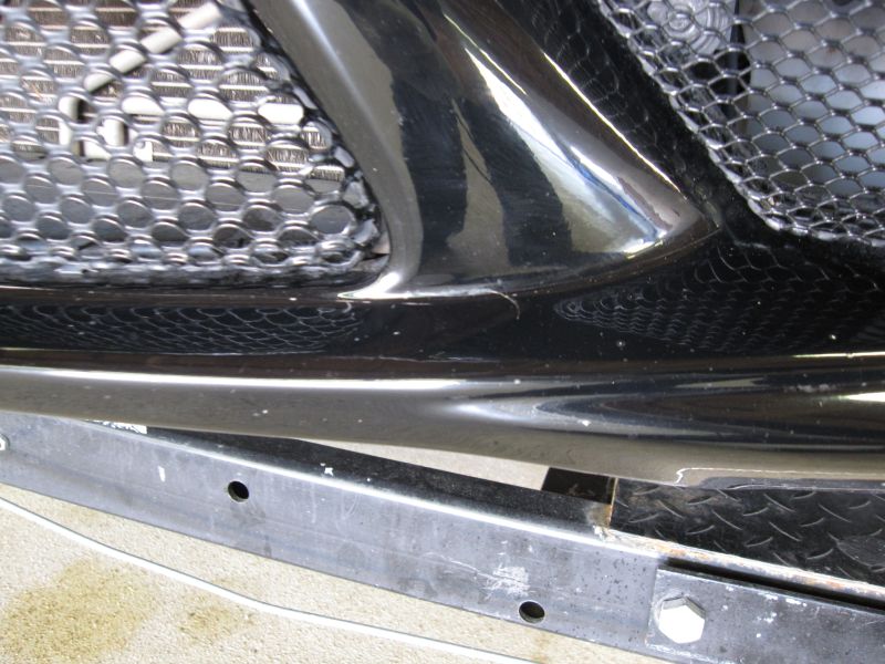

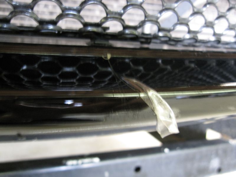

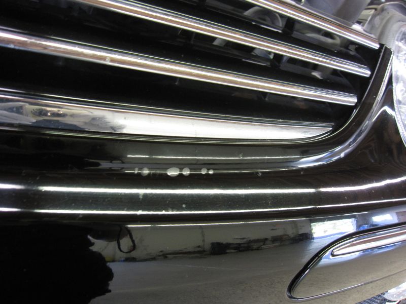

Just to point out a few key points with clear bra installations:
1. installer is #1 key to how this will turn out
2. do not shop based on price. The "cheaper" installers generally do not have much experience and rely on pricing to attract bargain hunters to help gain experience.
3. inexperienced and even some professional installers oftentimes end up damaging the paint on cars with razor cuts
4. important to look at the finished product if possible.
Below are some shots of a C55 with a "cheaper" clear bra installation. Customer decided to utilize another company based purely on price. He ended up bringing the vehicle after his previous installer failed twice on the installation. Just another note, after the 2nd fix, the installer stopped answering his calls and because this installer was mobile, there was no way of the customer tracking him down.
There were deep razor cuts in the paint of this Mercedes. We did what we can to polish, but there were some that were too deep.

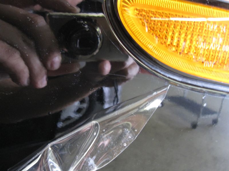

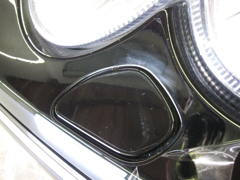

close up shots of the deep razor cuts the previous installer put onto this "custom" application
Note - not all custom installations are equal. It requires many years of just pre-cut installations to become proficient at clear bra installations. And many more years after that to become a master of this craft.
Too often, consumers would consider all precut installer = to another precut installer and the same for custom = to another custom job.
This is a mistake especially when the priority is cost first. Instead, quality of the job should be the priority...otherwise, if it is out of the budget, it would be better to not do it at all as there is significant risk in paint damage from inexperienced installers.

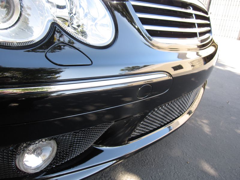

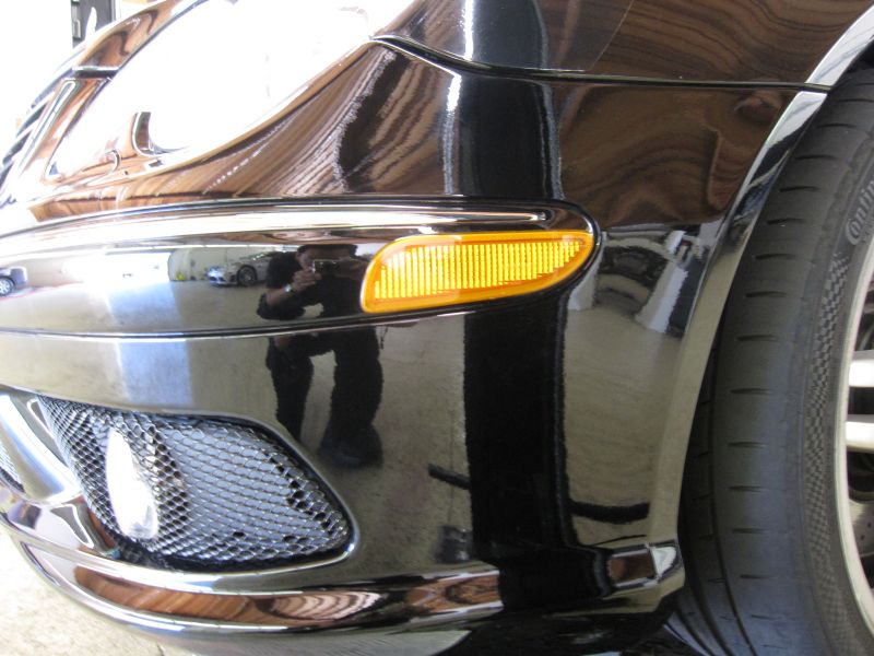

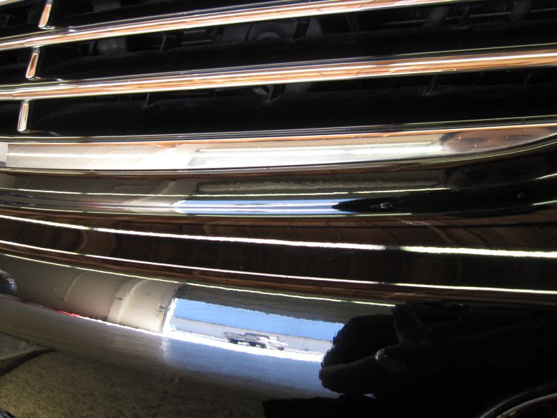

Here are some shots of the clear bra completed by our team
