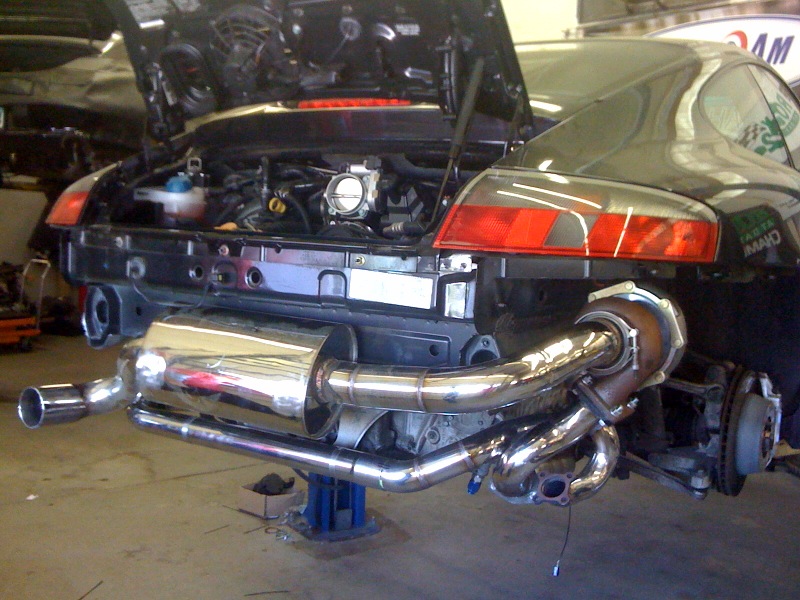

Bob's car, in line for the final dyno, all aligned and ready to go!
Along with the 996 3.4L we are also working on this PDK gen 2 car...

Alright, Updates.
Bob's car should be finished in the next day or so, mike just got back from being out of town and we just sent out the rear bumper brace for a little squaring up.
Pics of Bobs car...
Pics of Markar's Car(996 3.4)
3.8L DFI PDK Getting the treatment...
Nick building an Intercooler...
Updates will be later in the day.

Originally Posted by utkinpol
Waw, great picture - first time I can see where you put oil line into.
So essentially you just unscrew that plug that is in stock engine and put line in. I looked at mine - not sure how do you get it out? Just kern it and rotate?
Are you sure if this connection is safe enough? It protrudes a bit low - I guess if you knock it hard enough at something like a stone or a branch on a highway - you will essentially spill all the oil out? Aren`t TT cars have something more solid there or is it essentially same set of thin tubes?
PS. If anybody owns TT car - would you mind post here or PM me a picture of same engine spot?
It isnt a screw, you actually have to tap the freeze plug and then thread in the line. We used to use an aux oil pump, that were incredible quality but they kept failing due to water/salt etc...
We have done tons of them w/o issue. It becomes a solid part of the car at that point.
bottom of turbo car... Same idea:
both are turbo oil returns.

I cant accurately answer your question Paul, but I can ask mike in the morning. All I can say is that with the cayman kits that have had this conversion, using this oiling, we have never had an issue... in all climates and conditions. I looked under bobs car today and saw that the rear subframe is lower than the oil line.

Coming right along on Markar's Car...
Crummy iphone photo... I apologize.
