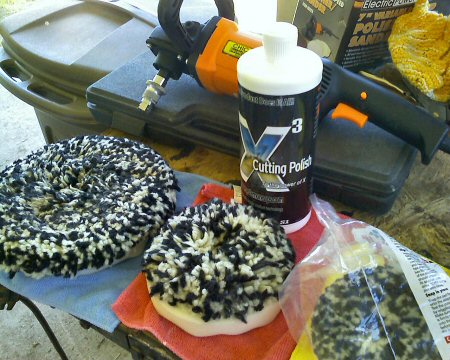

Did brothers Z and my truck yesterday using system one and harbor freight circular buffer at about 500 to 1000 RPM depending and they came out great and the truck had superglue dripped on them that burned the plastic lens.
1. 1500 then 2500 wet dry sand paper.
2. Used system one polish that came in kit and also use to buff the car.
3. Used the 4" buffing pad wool first then flipped over to the polishing pad to complete the polish.
It did take some elbow grease with the 1500 sand paper because we had to take down allot of plastic to get rid of defects.
