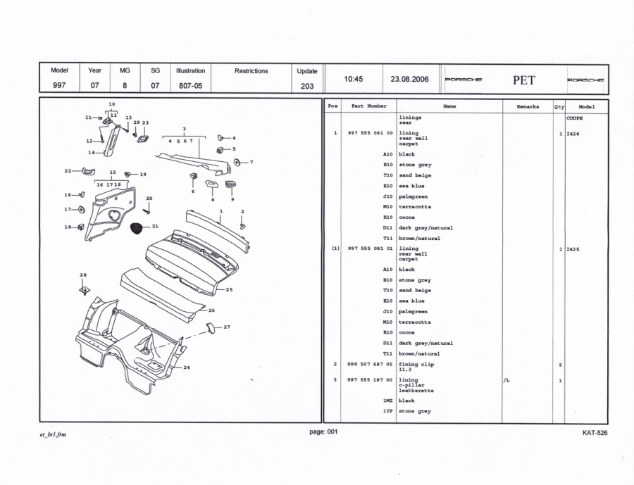

Sorry I haven't been able to post a picture of the piece of molding that had the loose clips (keep forgetting to charge my camera..but I will), but I can say that the noise seems to have gone away. The loose clips were on the carpeted piece that is right below the rear window, and on a right angle to the back carpeted deck, if that helps any.

It would be great if someone had a PET diagram (I think that's what it's called) so we could see the area in detail.
For BMW they're available free online. I don't know for Porsche...
It's hard to read numbers, but does #6 look like the clip you're referring to?

If you are talking about part number 999 507 687 05, then yes, that is exactly it. It lists 5 of them, and 3 of mine were not clipped together.
