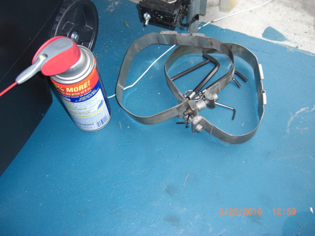

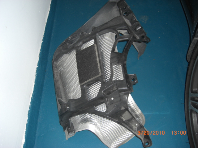

It's really not that different from the 997.1. I tried by myself and actually accomplished it. It's not exactly difficult but certainly laborious.
I used this write up to get started. It's a DIY for the bumperettes, but it fits the purpose here. I used the blue tape on the pics just to make sure of the alignment afterward. Held the rear lights up so I wouldn't need to fiddle with more wiring, not really necessary in retrospect.
Removed the lateral mufflers first, front connections then the rear ones. Removed the bracket attached to the cat junction, that holds the lateral mufflers. A third screw is left behind at the cats, needed a little extra effort for it because it's a but deeper.
Then, removed the braces that hold the central muffler in place. Swing it a bit and will come right off.

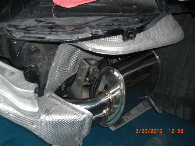

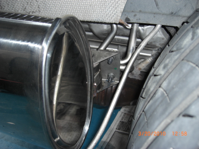

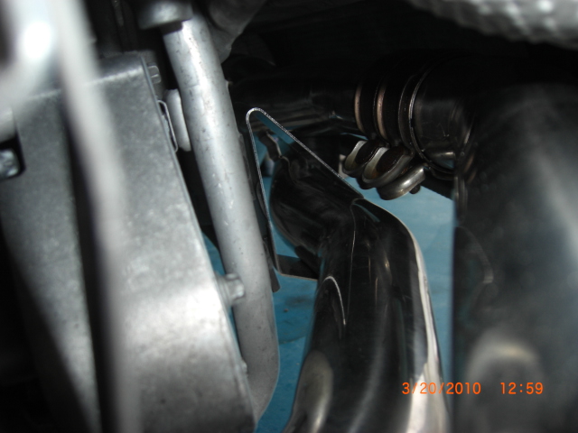

Installing is pretty much the reverse, except for the tips with the distal connector (see pics). I re installed the bumper first before connecting the final part just to make sure it fits equally in both sides.
Screw it all back together and turn it on. Piece of advice: User proper tools, gloves (the heat shield cuts) and lots of WD-40.
The sound is amazing now. I got exactly what I wanted, at least idling... A deeper tone, definitely louder. With closed doors you can hear it still, much closer to the Boxster experience. A much less tamed car so far.

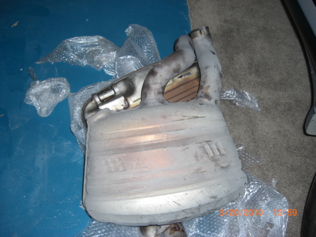

Check out the Agency Power stainless steel finish, compare to the bulky dull original...

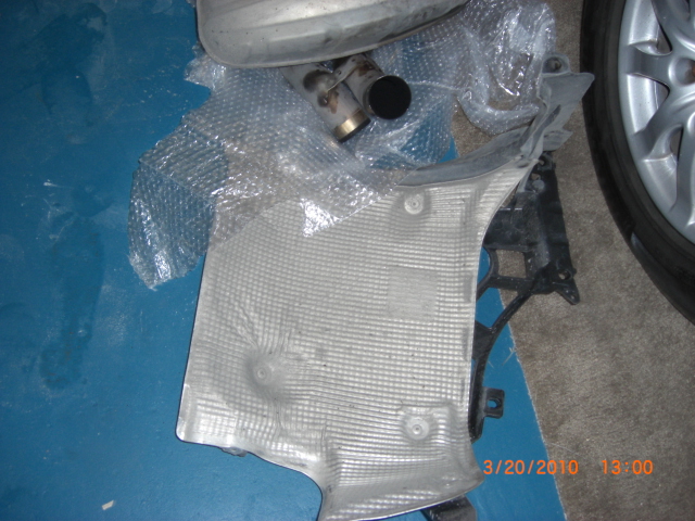

Few more details, brackets (core is reused), the muffler itself, heat shields
