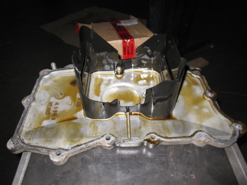

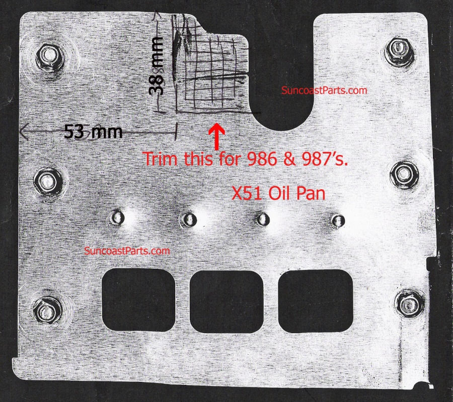

And poured in 6 quarts of 15-50 oil mixed with 2qt of 5-50 oil. Process is very simple, it only required a little jig saw operation to cut off part of the baffle as Suncoast suggested it would be needed, but looking at original oil pan it was clearly visible where to cut. Most dangerous part of whole operation was not to overtight bolts during mounting it all back.

Not sure what to show, really. It was literally very easy, took old one off, put new one on. Suncoast includes sealant in the package, one should be careful not to put too much of it on so it would not protrude into engine as it can get loose and clog something.

Only relevant picture is this, attached.

Did you try to cut that corner how I showed on that attached image?
Well, after I removed that corner it did go into place. what is somewhat nice - those baffles have rubber edges and edges were tight against engine walls so it should hopefully create better oil pool around pickup than with stock plastic baffles design.

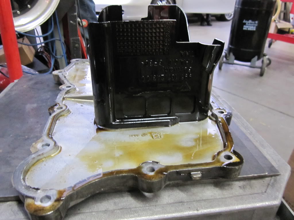

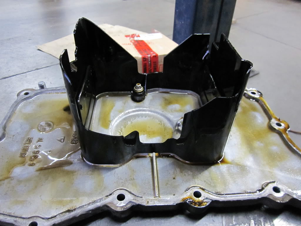

here are pics of the stock 997 3.8 oil pan... look a lot like the 996 X51:

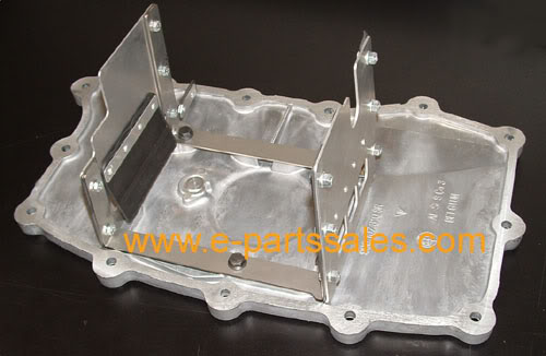

Here is the X51 pan:
