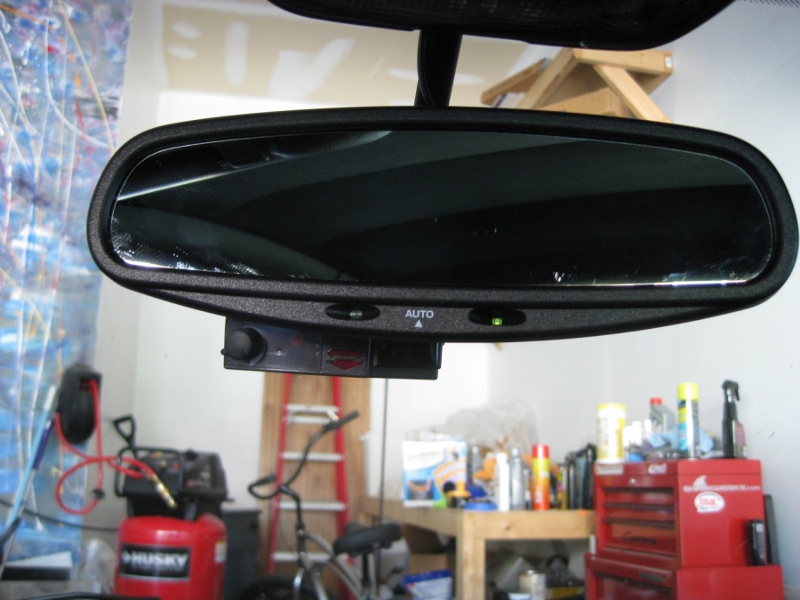

I hardwired my V1 yesterday. It's a very simple install. I have it wired up by rearview mirror, the wire is run from rearview the headliner across drivers side, then down to front of dash, carefully tucked in, then back towards the door, under the rubber trim, and down to the fuse box. You unscrew the 3 screws and whole piece come off for you to hide your wire kit. I used the fuse for the rear wiper which is a switched fuse so it goes on and off with the car. I don't have a rear wiper so it was the perfect fuse to use.
Also once you remove the cover you'll see the perfect ground, loosen that nut in front and lock it down. Test before you button up.
I have 2 current 997's and I did the same install in both. Been working over a year flawlessly in my 09. Just offering an alternative install for you. I don't like tapping into the map lights, or ignition. This way is easily to reverse also.

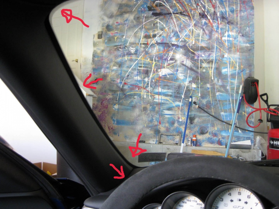

I appreciate the positive feedback. I took some pictures to go with my explanation. I have done almost the identical installation on 8 cars that remember. The only variation has been which fuse I have chosen. The fuse for the rear wiper is perfect in our cars is perfect, unless you have a rear wiper that is.

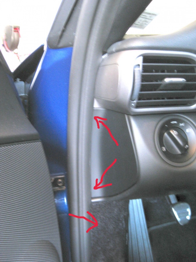

The arrows point to where the wire is hidden from sight. When you go along side of the dash, u will need a thin tool that is plastic, so you don't chip anything.

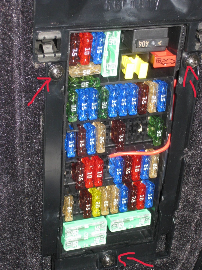

When you get down to the fuse box unscrew the 3 screws and that whole panel comes out, it may help to take out your floor mat. The ground nut will now be accesible, and a good place to hide your wiring kit. You can use the fuse puller tool included or snub nose pliers to remove your fuse.
You cut the end of the red wire off and strip it. Make sure you strip enough off. You're going to guide it in the top of the space where the fuse goes, and insert the fuse. This may take a few times, and you want it tight. Gently tug the wire to make sure it's in there. Once you have this and the ground done, turn on the radar, now put your key in the car and turn it, no need to start the car. See if your radar powers up & it should!

Scott, hate to bring threads back from the past, but I tried doing this the other weekend, and ran into a number of "issues" (electrical). My car is a C4S with PDK, if that matters at all. Everything you put was just fine, except for I think I got confused in the fuse box. In the photo you put, the fuse socket that you used has a 15 amp fuse. I stuck the wire into that fuse, and the detector did come on, switched, but the fuse was still out. The car would not start, and the engine reported that it was in limp mode. I had to pull out the detector wire and re-insert the 15A fuse to get the car to start.
Can you clarify again what it is that you did with that fuse box? Where does the red wire go? How do you get it to where it needs to go?

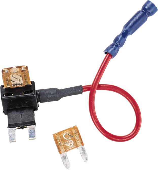

You probably just need to find a fuse that is not being used.

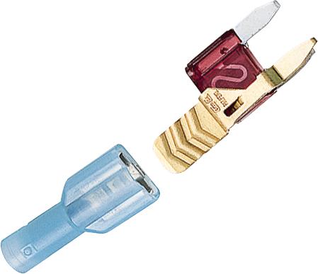

Has anyone used one of these - Fuse tap. Makes the fuse install look professional.

Burbel, I'm so sorry you ran into some trouble. When you open up the fuse box theres a small booklet. Find the fuse number that corresponds to the rear wiper, which you most likely don't have and use that. I think you may have pulled the wrong one. You can always ask your Porsche tech for help too if you have a good relationship.
