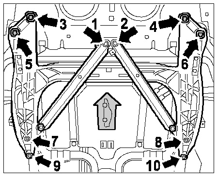

At the bottom of the post there is a image of the subframe that I may reference from time to time.

5- Get under the car and find the 10mm bolts near the actual 5 and 6 numbers on the diagram. There are no arrows pointing to them and they're fairly small. They affix a support for coolant tubes and if you start lowering the frame before you remove them you could tug on the tubes and risk a coolant leak.
6- Stay under the car and get to work on the subframe. Take note that it will only drop about 4-6" because it's still attached at the top. The bolts are 18mm and usually aren't too tight. See the diagram at the bottom to ensure you've removed all of them. The sub frame will begin to drop. If it makes you feel safer you can just back the 7 and 8 bolts out but leave them attached.
7- There are two 15mm bolts to the left of the "5" and two to the right of the "6" in the diagram that hold the sway bar mounts. You'll need to use a 15mm wrench on the inside of the wheel well on the top of the subframe while you loosen it from the bottom. Take the bolts right out and remove the plate that holds the bar and bushing in place.

#5, 6, 7, 8, 9, 10 - 118 ft.lb.
#1, 2, 3, 4 - 74 ft.lb.

Don't worry about removing the tie rods (#4 above), it can be a right royal pain irrespective of the method used - remove the LCA's (lower control arms) instead, doesn't require any special tools. It's much simpler & gives more room when removing the sway bar. You just need to remove the inner bolt & slide out the LCA from the subframe. Loosen the bolt before lowering the subframe, remove the LCA when the subframe is lowered (i.e. new #7).
I did #7 (remove sway bar bolts) straight after #3 (i.e. new #4) , it's easier than when the subframe is lowered. #8 is actually the hardest part of it all.
