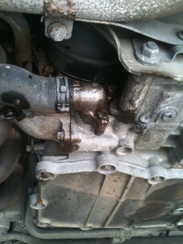

Old Jul 6, 2010 | 08:49 AM
mshanler's Avatar
Joined: Sep 2009
Posts: 218
From: Sudbury, MA USA
mshanler has a spectacular aura aboutmshanler has a spectacular aura aboutmshanler has a spectacular aura about
I was leaving a very fine trail of liquid near the drivers side exhaust for a few days, but couldn't see any obvious signs under the car. I attributed the trail to AC condensate... as I only saw the leak marks on the incline part of the driveway.......however, after a few days, I checked the expansion tank and saw the coolant level had dropped below the "MIN" level....so I set up an appointment at a local shop that day. On the way, my slow leak turned into a giant leak, and the dash-warning light popped on with about 1/2 left in the tank. I cranked on the heat and raised the spoiler and limped into the shop- I arrived with a few teaspoons left in the tank.
Pump was replaced. Leak is gone. I'm happy again.
