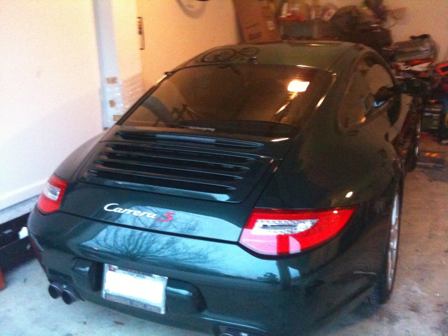

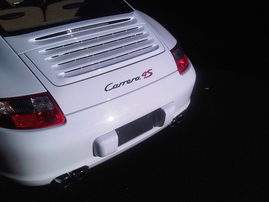

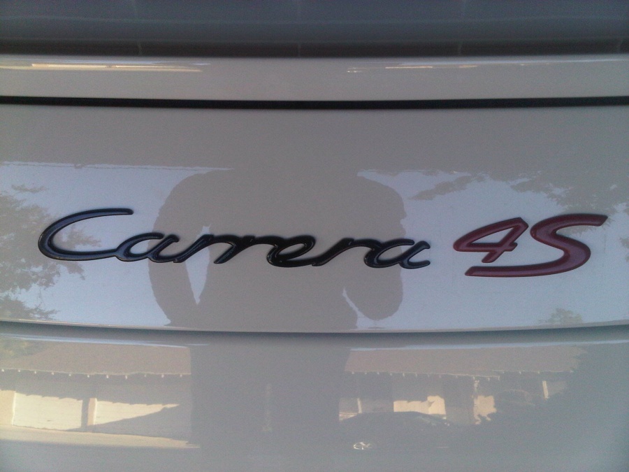

I literally did this today to my '08 C4S - I did black "Carrera" with red 4S -
This guy's description was the best - and exactly as I followed. Pictures attached. (from my blackberry - doesn't do it justice - looks really good). I ordered new emblems - makes life a LOT easier.
