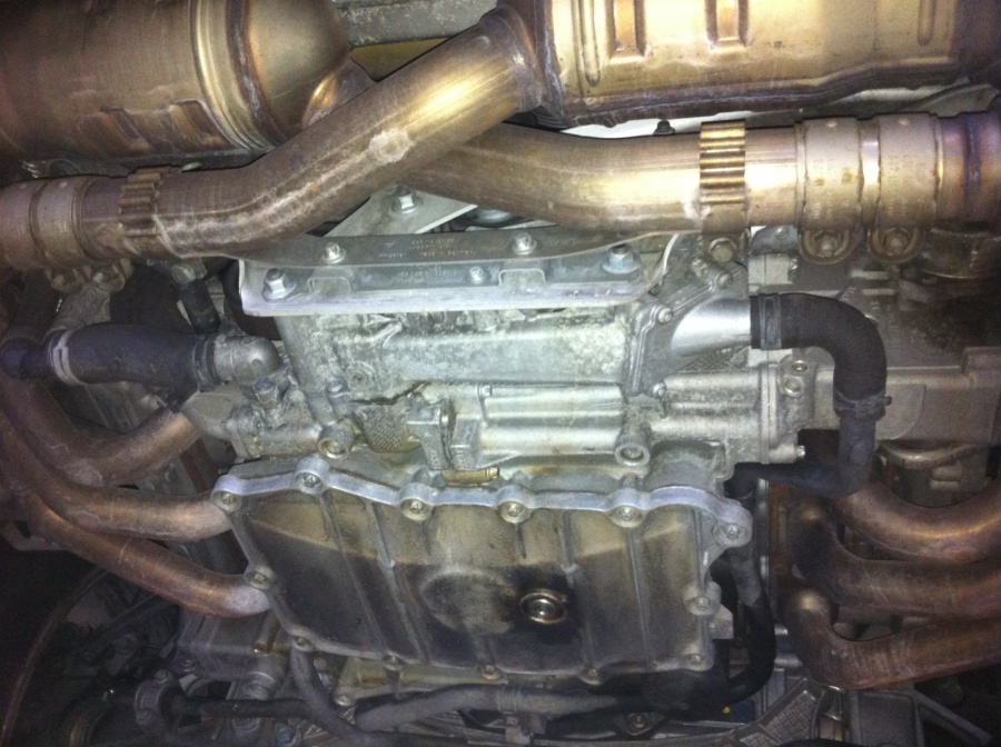

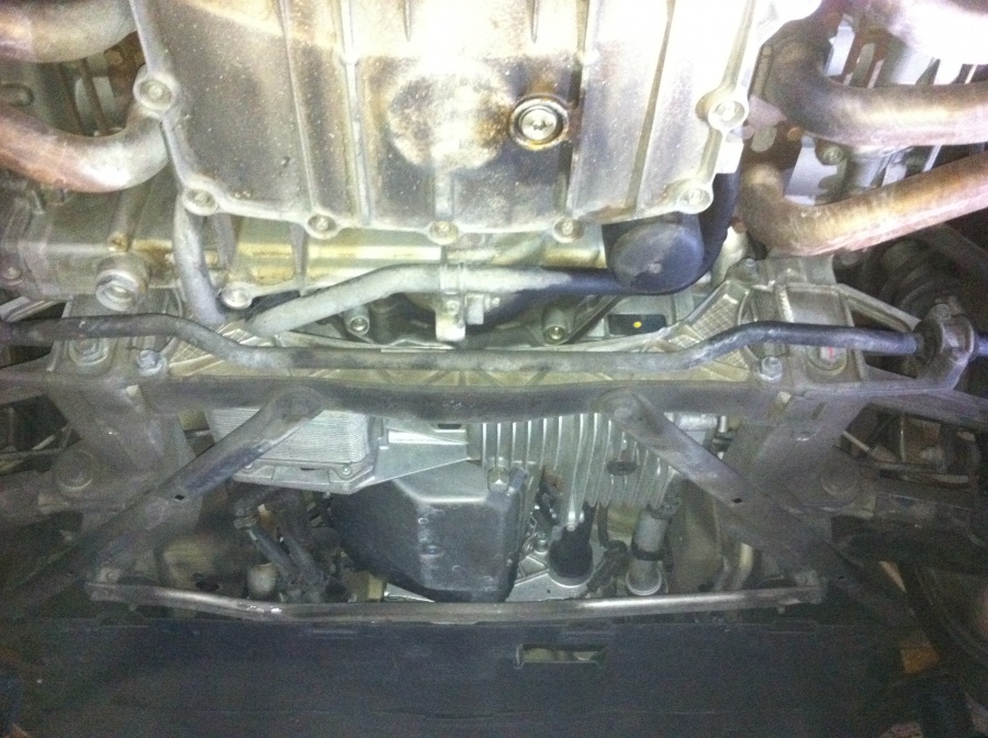

Thanks. Any idea what I should budget for a new battery & starter harness cable if that's what it is? Also, is this a problem that might have been happening for awhile or is it dumb luck that it happened when I decided to keep the car in my garage instead of returning it until the deal takes place?
The tech said it looked clean & dry underneath, but I know that's no guarantee. A couple of images while the car was in the air...

A battery could be under $100. I hear the starter cable installed is about $700.
