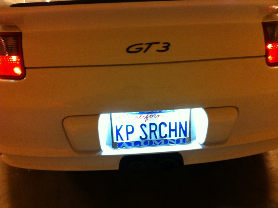

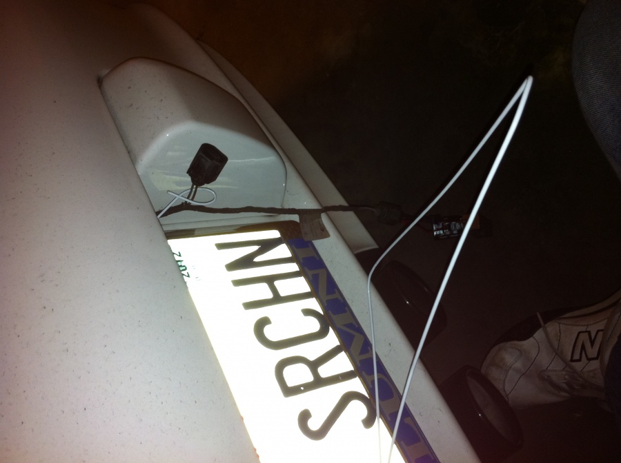

Okay everyone, I figured it out. One of the ends of the "Y" cable that the two harnesses are connected to is very short. Basically just by moving one end, you will pull the other end out of place, forever lost inside your bumper.
But here's the solution: pull the entire Y-cable out of one of the holes, gently. You'll see both harnesses dangling. (Photo 1)
Take a hanger from your dry cleaner and bend it into a hook and put it through one hole and out the other. Then clip it around the shorter harness and pull it back through gently, while holding the longer one in place. (Photo 2, 3)
Attach light assemblies and put it all back into place... (Photo 4) As you can see it looks pretty good.
