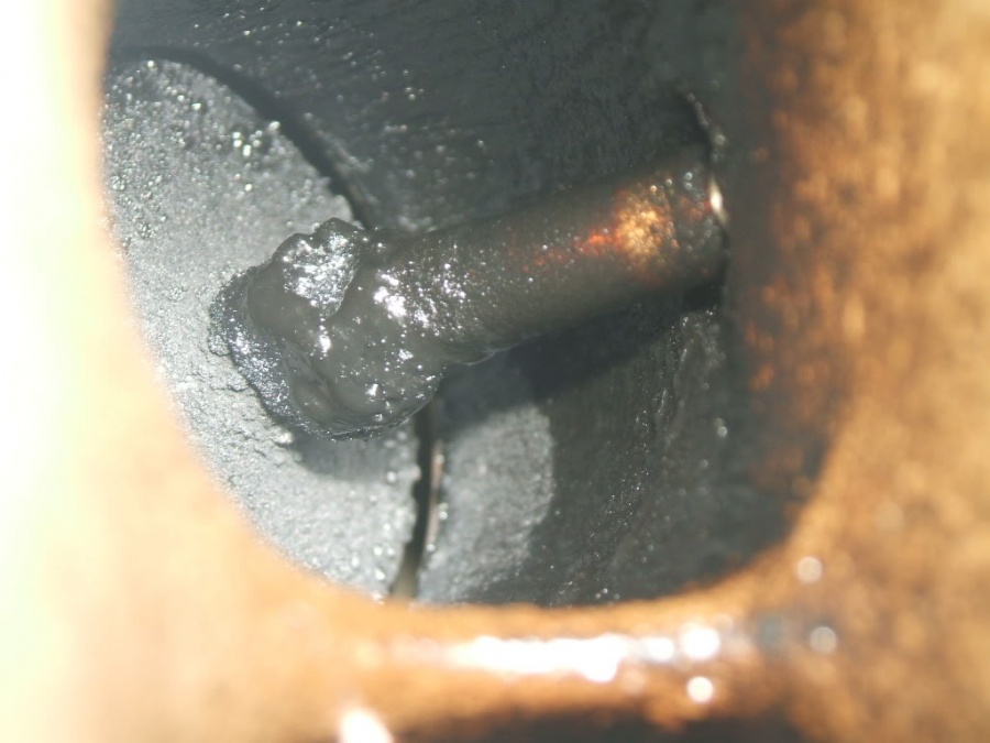

This is a pic of a DFI Cayenne engine originally posted on RennTech. I have seen similar pics of Audi DFI engines. Not sure if the boxer style engine will have any impact, positive or negative, on this issue.
Yes, that is a pic of Cayenne engine and I first posted it here when the question arose at the time the 9A1 DFI engine was released... The conclusion then was that the boxer DFI design was different and that should not be an issue. So far I heard no reports, and there are several 50k+ mile cars out there.
Those raising the 9A1 fear spectrum please address the following:
1 - How many 9A1 DFI engines have you seen with that problem?
2 - Please post a 9A1 DFI engine intake tract gunk photo
If no answers to those questions... I suggest stopping baseless speculation.
To those who worry... learn about Top Engine Cleaner service...

I do not have any such pictures but I would be very surprised if there were no carbon buildups with boxer engines. Remember, relatively speaking, there are very few Porsches out there with DFI. Why would you think a 9A1 engine would be any different than other DFI engines in this respect?
Again, the carbon build up may not always result in a problem for some cars.
Because the geometry is different in a boxer engine. The injector may actually spray the back of the intake valve.
