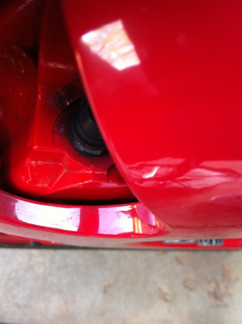

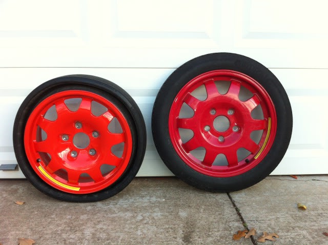

The 16" collapsible spare will fit your 05. The boxster 17" bicycle tyre will also fit. Picture of the two tyres. The boxster tyre has to be put in at an angle to fit in the frunk.
The boxster tyre clearing the caliper.
