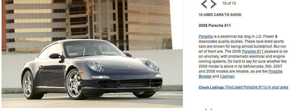

Not sure why msn.com says the 2006 Porsche 911 is one of the 10 used cars to avoid? They even say it is a anomaly?
Here is the link http://editorial.autos.msn.com/10-used-cars-to-avoid#10
Name:	Screen shot 2013-11-06 at 12.16.41 AM.png
