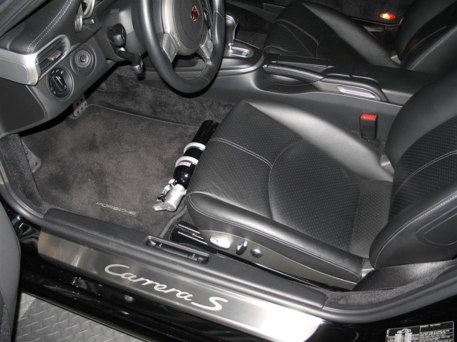

I did mine a few years ago. The hard part (and I mean hard part) is removing the plastic ones and the adhesive residue that is left on the actual sill. It takes lots of elbow grease. I used a 3M adhesive removal product. Even employing the 3M chemical help whatever Porsche uses is super strong. I used plastic putty knife (didn't want to scratch the painted sill) to help. I think as a final step I used either acetone or lacquer thinner w/ rag very carefully get all the 'goop' removed.
If I recall the SS sills already had 2-sided tape so it was just a matter of positioning the correctly before pressing them down.
It's not a technically tough job. Just be patient and use some muscle to get all that goop off so you have clean surface for the new SS sill plates.
Have fun . . . .

WOW, that looks beautiful. Thanks for the advice.

No problem . . . What is really nice about the SS sill is that they are virtually impossible to scuff unless someone is wearing golf spikes or steel soled shoes. The regular black plastic sills get easily scuffed and marred.
