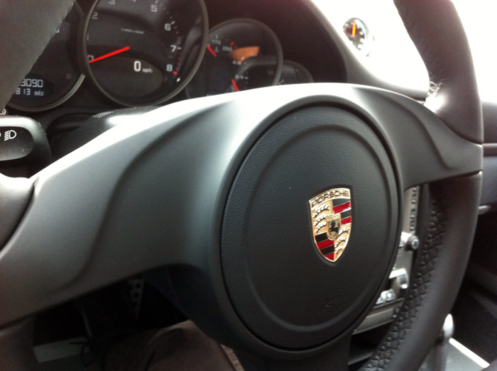

I swapped a heated multifunction wheel for the OEM non–heated multifunction wheel in my 2012 GTS with heated seats and 6 speed. Pretty simple: had to install a new clock spring and controller followed by recode.

Sorry for the delayed response; I have been offline.
The necessary parts are:
Clockspring - 955-652-211-22
Controller - 997-613-299-02
These parts are for replacing a non-heated multifunction steering wheel with a heated multifunction steering wheel in a 2012 GTS, but I believe they will work for a 997 or a 997S as well, provided it has a manual transmission and heated seats. I don't know what model years these parts will fit other than 2012, but it seems reasonably likely that they will fit most or all recent 997.2 production.
I did not install these parts myself, partly because of confusion and differing advice regarding which parts were correct. My dealer did the work, and the prices were $96.36 for the clockspring and $343.56 for the controller. That at least gives you a ballpark idea of the cost, and a point of comparison for an online search.
Hope this helps.

Yes, the new clockspring is necessary, according to my (dealership) mechanic. I don't know why. The mechanic didn't think a new controller would be needed, but, if I remember it correctly, there was no provision to connect all of the leads from the new heated steering wheel to the OEM controller. There was, I think, one lead "left over" with no place to plug it in once everything else was connected. At least that is what I recall.
