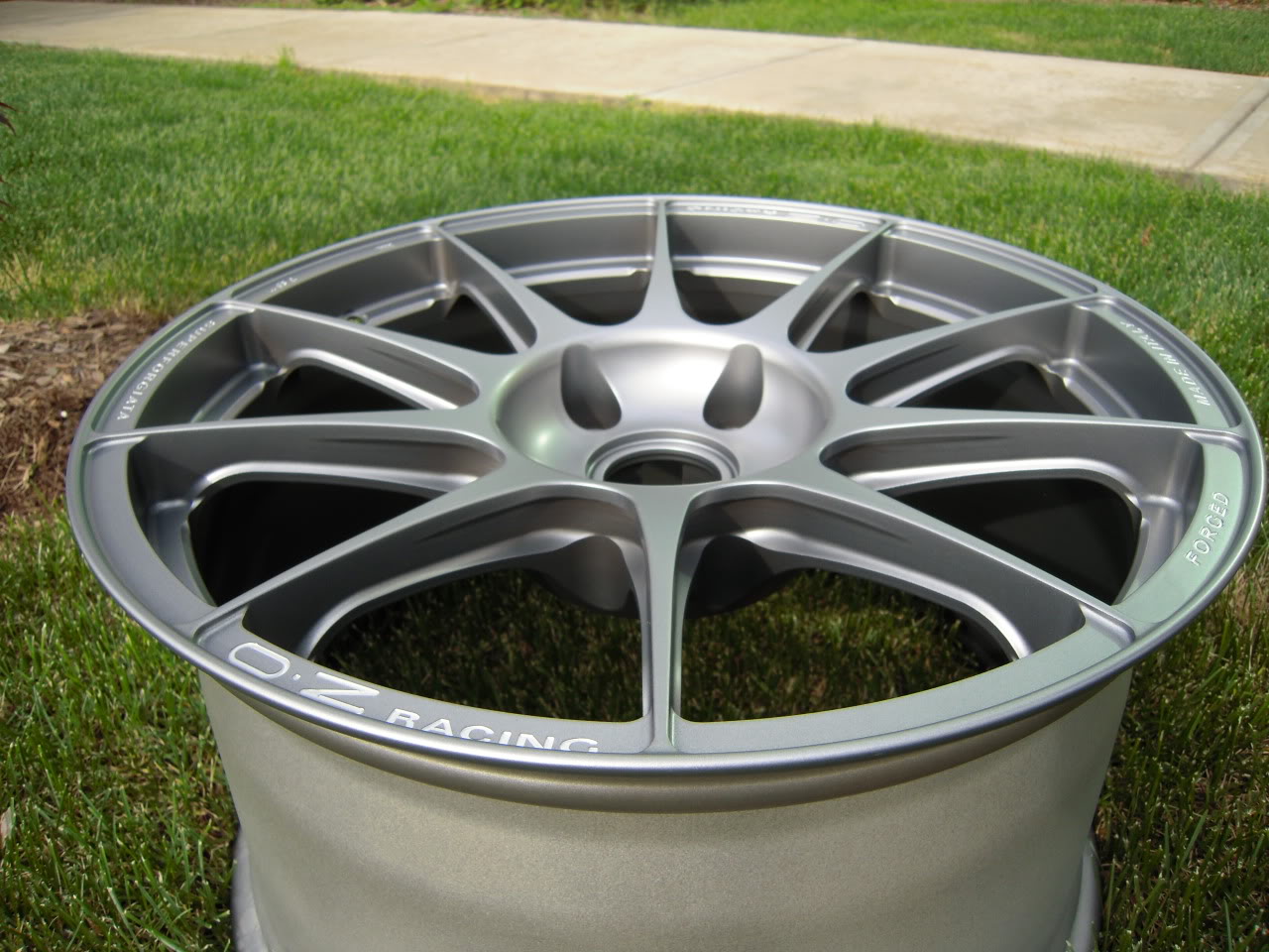

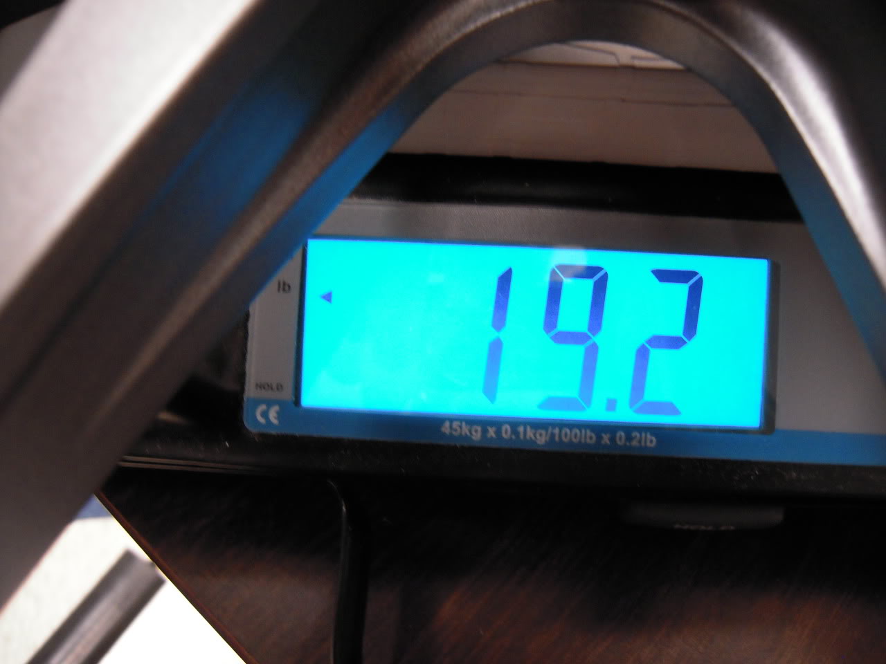

OZ makes the Superforgiata at 16.5 lbs. front (19X8.5 5-130 ET53) and 19.2 lbs. rear (19X11 5-130 ET51) for about $1250 each. i have them in grey, and will in black soon.

Same size in the Ultraleggera will be 18-19 and about 23-24 lbs. rear, but half the price.
