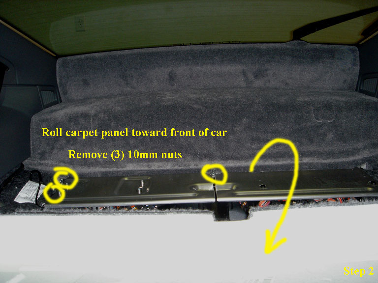

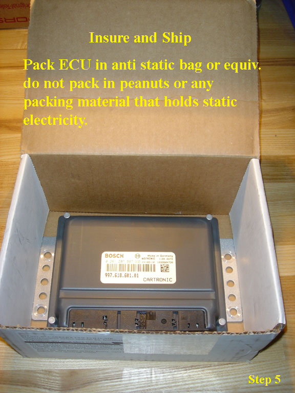

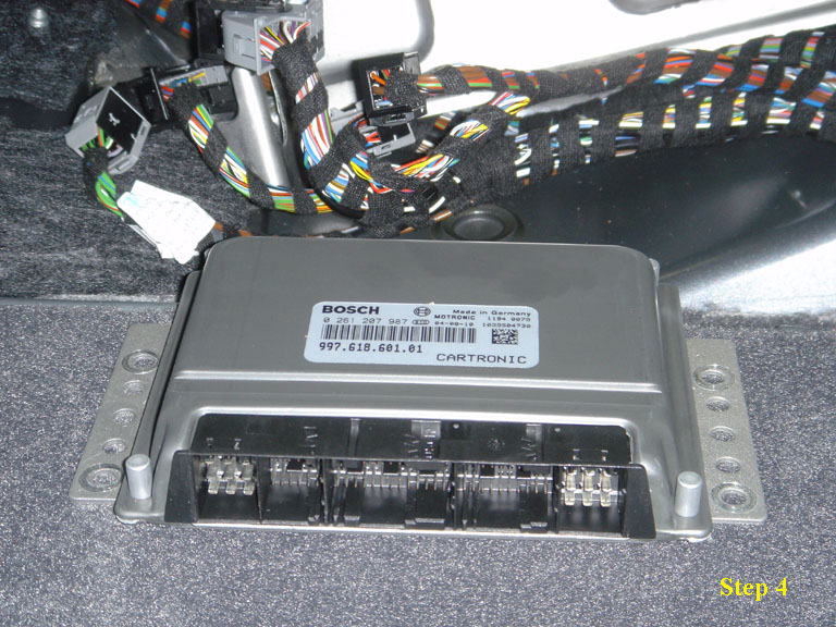

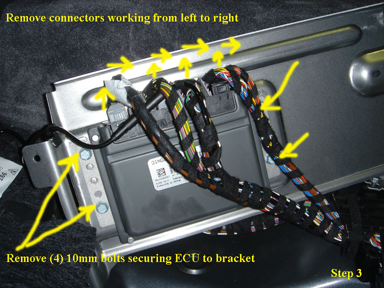

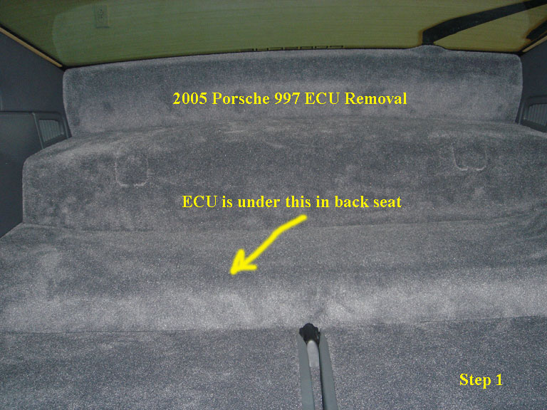

I GIAC flashed my 997 about a month ago...It's not going to give you what you're looking for. FWIW I did notice some gain in torque...
Here is a how to on the ECU removal I did...just incase someone wants it.
Old May 3, 2005 | 02:33 PM
VB997's Avatar
Joined: Feb 2005
Posts: 48
VB997 is infamous around these parts
step 2
Old May 3, 2005 | 02:34 PM
VB997's Avatar
Joined: Feb 2005
Posts: 48
step3
VB997's Avatar
Joined: Feb 2005
Posts: 48
Step4
Old May 3, 2005 | 02:36 PM
VB997's Avatar
Joined: Feb 2005
Posts: 48
step5
Old May 3, 2005 | 02:50 PM
911 flyn's Avatar
Senior Member
Joined: Mar 2004
Posts: 730
From: So Cal
Rep Power: 52
911 flyn is infamous around these parts
VB,
Again , nice pics and directions.
