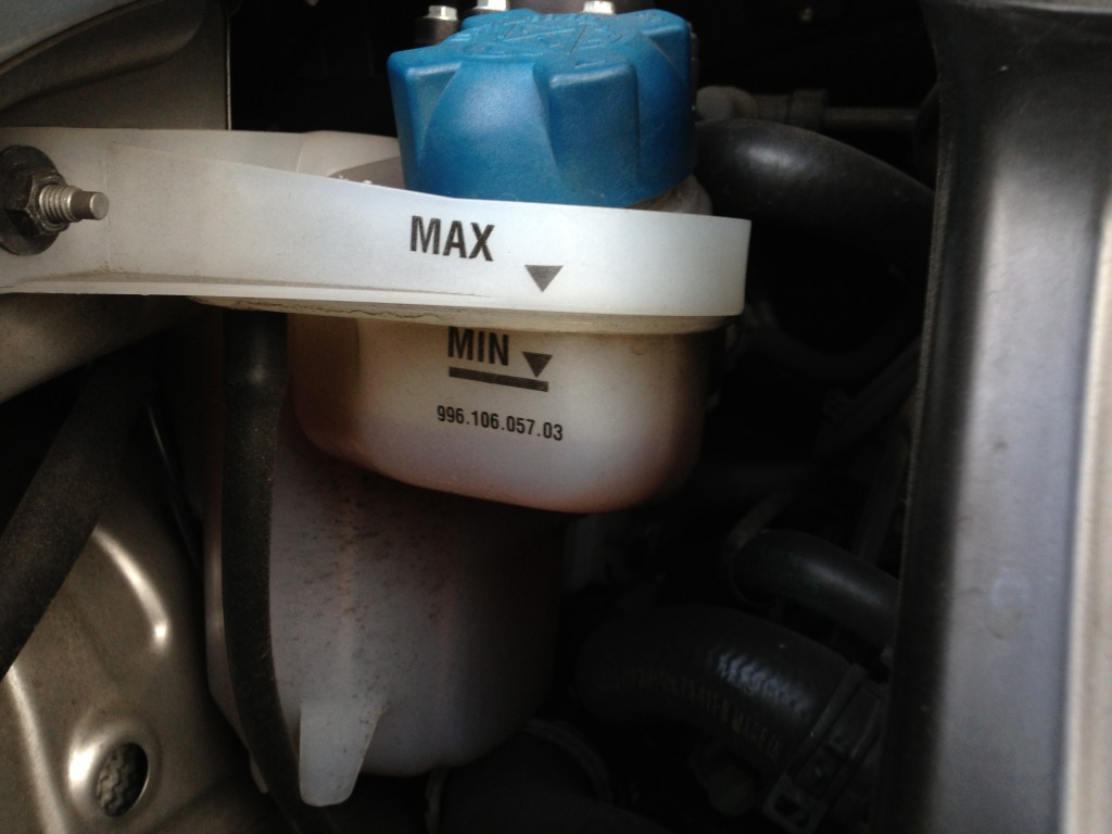

is this the right coolant reservoir part for my 997?
I couldnt get the cap off so cant tell which version cap it is

Re: is this the right coolant reservoir part for my 997?
Hi Sameerg,
The part number is on the top of the cap. You don't to take it off.
Now you said 997, but the reservoir is 996.106.057.03. That is exactly the same reservoir I have on mine and the cap is the same too. The cap number does start with 996.106.447.00. That is what came with the new reservoir when mine cracked or I cracked it during the DE at Putnam last year. You need to replace it with the .01 cap. If the picture is from a 997, they are clearly using the 996 reservoir. Hope that helps.
I bought a new cap...and now I can't find it (somewhere in my garage), but the leak was coming out of the reservoir, not the cap. They are hard plastic and it is not infrequent for them to crack. You may have to have the car running, shut it off and then see where the leak comes from.

I do not have any leaks at all..... clean garage floor. But was just alarmed to see the coolant being low yesterday. I am going to get to the dealer tomorrow for a new cap though.

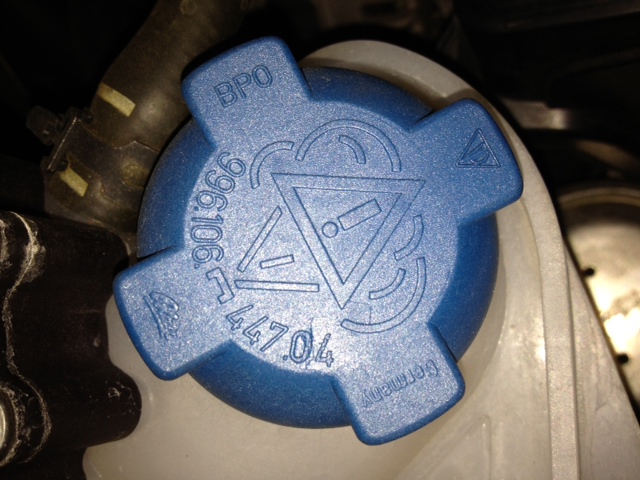

Where exactly on the cap is the number? Mine has a large print number ending in 01 but without the . before the 01?

If you look from the top down here's what the .04 on the cap looks like on my 997.2 car
