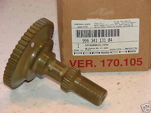

Does the tension bolt that your hub bolts to have a toothed or smooth wheel on the backside for the sensor? I hear that on cars with the toothed wheel it doesn't matter which side the bearing is mounted.

By tension bolt do you mean the spindle with the big axle nut on it? If so that is about 4" in diameter and is smooth and round with a hex style hole in the middle to hold it while tightening the axle nut.

Yes that's the one. So yours was not toothed like below? If yours is smooth then I think the ABS sensor uses the magnetic side of the bearing for the reading. But if yours is toothed, then I think it would be an inductive sensor reading the pulses off the teeth.

Yes, mine is definately not toothed like the one pictured. It is smooth and round so all my struggles was simply the magnetic strip on the wheel bearing. It was made in Slovakia, it said '***' on the box and came with zero instruction or indication of a magnetic strip. But red definately goes to the outside of the car.
