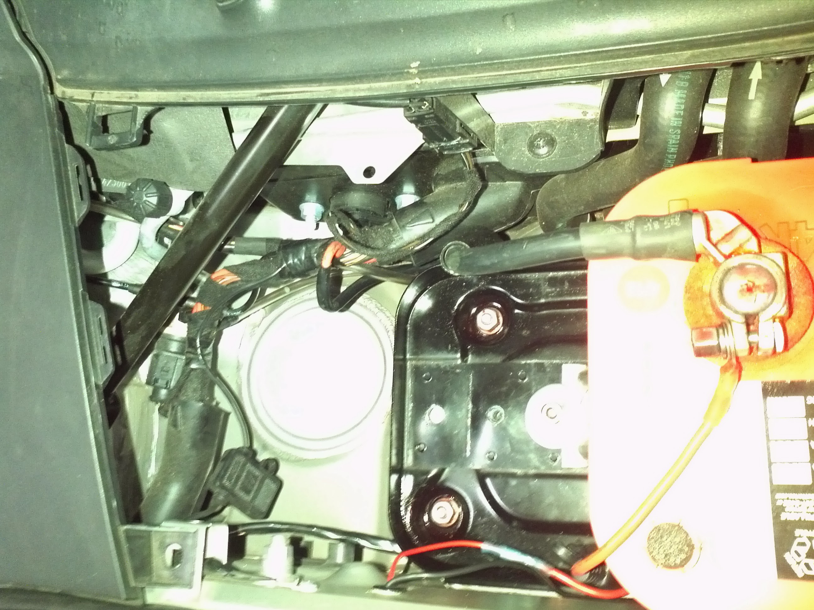

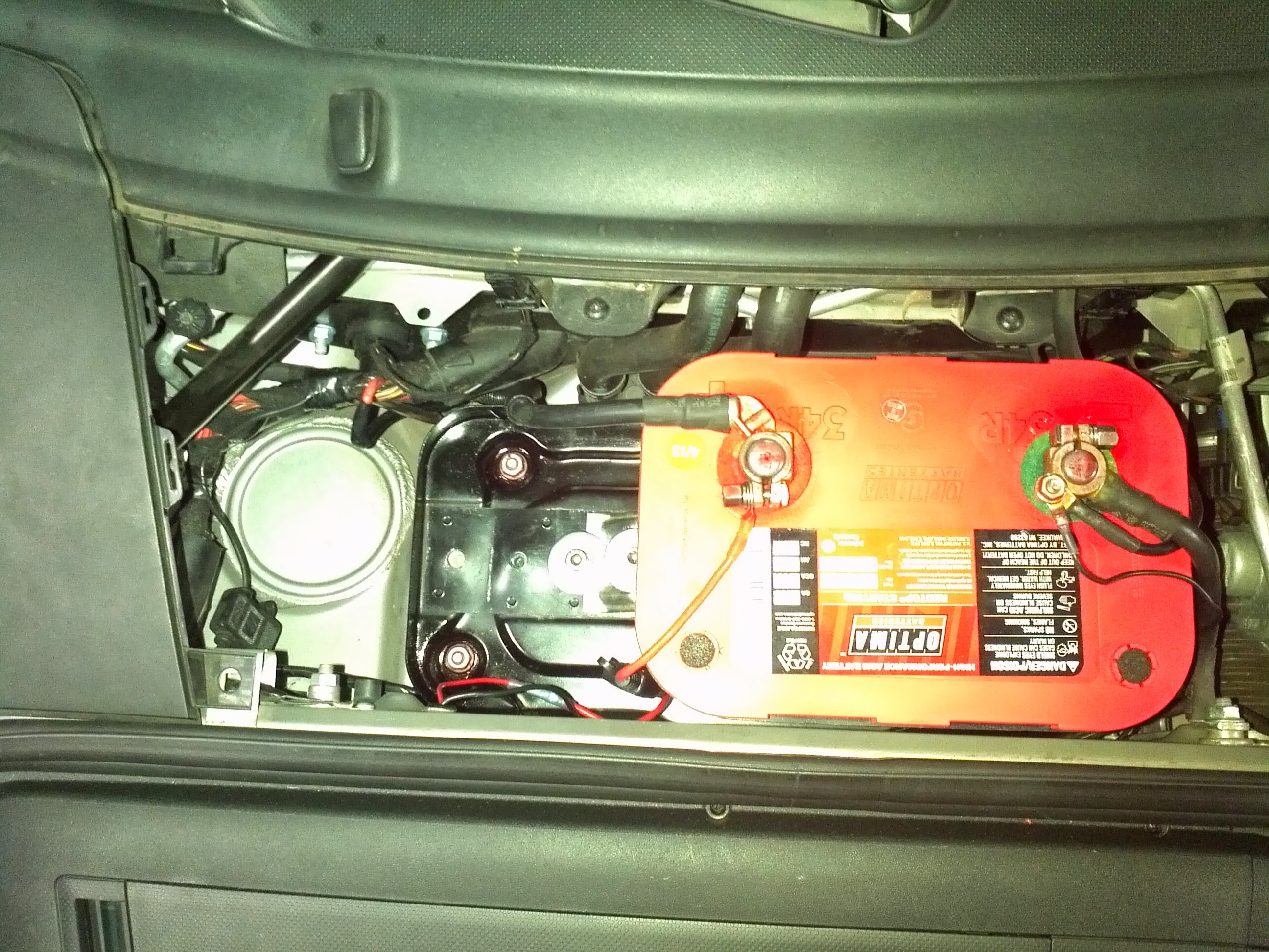

Optima 34R
Found a couple photos of my Optima 34R Install. I apologize for the photo quality not being all that great, but it does show how much space the Optima saves on the OEM battery tray (this was one of my primary objectives to have enough space to mount a small compressor).
Very cool. I know from the OEM H7 to the bigger H8, I can also put in a smaller version (H6?) which would save space.
Do report how well the lower capacity battery works out.
