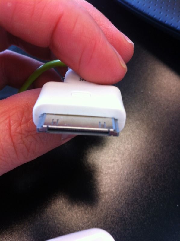

Pictured: is a male end of what would normally being coming out of a car or ipod dock. What I need is a female end that goes on this (like bottom of iphone) and then a cable that turns it back into a usb.
Does it exist? LOL probably not.

You can get iDock extension cables that have the end you need, and you can get USB cables, so worst case you can make your own cable by splicing and heat-shrinking things.
Whats the goal /use case here for this cable?

solder, wire and this, http://www.podgizmo.com/p/91/-ipod-i...male-connector
looks like data USB is on pin 25 data (-) and 27 data (+) with power on 23 (5 VDC+) and 16 USB (GND -)
http://pinouts.ru/PortableDevices/ipod_pinout.shtml

Had this exact issue myself and came across this post in an Android Forum
Apparently, here is the part you are looking for:
http://www.cablejive.com/products/dockBossplus.html
Here is a discussion of the part above:
http://androidforums.com/nexus-suppo...micro-usb.html
