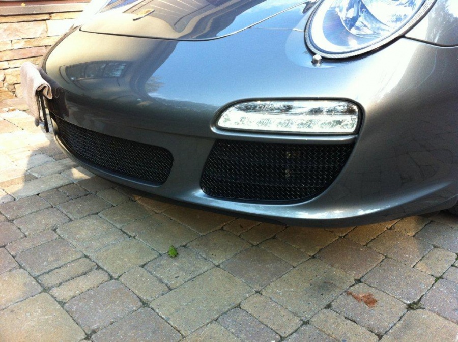

Photo of Zunsport install on '09 C2
Fyi, am offering unused FVD Brombacher grille set to good home; you pay postage

Thumbs up Zunsport installed on '09 C2
Sorry - here is pic

Q: It appears that on the side openings these added grills are in contact with the existing grills. Will they rub (scratch/scuff) those plastic grills?

Yes; this said, the Zunsport grilles are i) very well painted, ii) do not uniformaly contact all areas of the plastic, and iii) existing plastic "louvers" are farkuckt (technical term) and serve no function whatsoever, except to hide the radiators (and make it difficult to clean out debris). Frankly, I am thinking about leaving only the perimeter edges of the plastic side grills, and cutting out the louvers.
