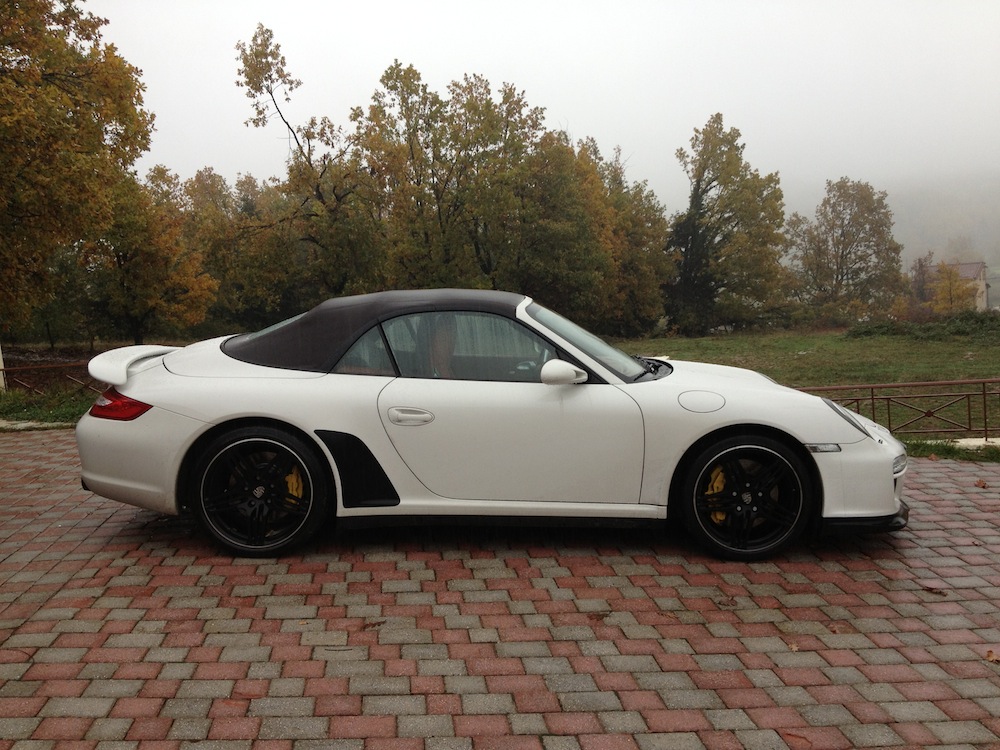

I have put in my 997.1 4s the turbo brakes front and rear but i didn't made any upsetting in the brake bias they told me that is working fine...do i need to go to ask them to do something?

They are steel brakes not PCCB so they around 350mm

That information came from a Brembo engineer. Maybe they played with the pad compound? The GT3 and Turbos use a rear caliper with bigger piston diameters and therefore clamps/squeezes harder thus upsetting the brake bias. I will try and find the message he sent me. There is a reason Suncoast Porsche removed the 997 Turbo caliper upgrade for the non Turbo 997s from their site...
