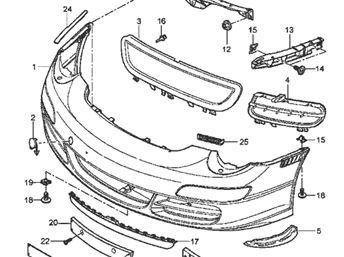

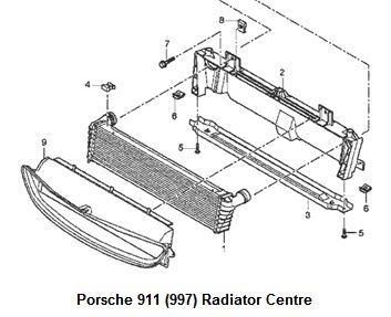

Originally Posted by micouremo
I am considering the 3rd radiator and was wondering if you have to install the open grille that comes with the kit. I currently have my laser/radar pieces concealed in the stock black plastic piece in front of where the 3rd radiator would go. I would assume the vents that allow air to reach the radiators assist in the cooling process and Im curious if installing the 3rd radiator without allowing the airflow defeats the purpose. Share your thoughts. Thanks
I'm not sure which parts you are referring to. In the first diagram below, the "stock black plastic piece" is #3. When installing the center radiator, that plastic piece is removed and then the parts shown in the second diagram are installed. You've also got to cut open the square cut-outs in the undercar surface of the bumper to allow the air flow to exit after passing through the center radiator. The stock side radiators aren't affected (other than the hose connections).

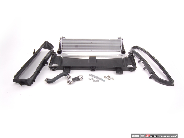

It will be significantly less effective if you install it without the correct ducting. I would think you still be able to mount the laser jammers at the top of the inlet (perhaps even attached to the ducting), where they would remain out of sight and out of harms way. For more information on the complete kit for the 997.1 and coolant CLICK HERE.
Guys, thanks for the replies. I am talking about the #3 piece. Ill get into my bumper this weekend and see where those pieces are actually mounted. There are holes cut in piece #3 where the radar/laser components are hidden but they are probably mounted to somewhere else. But Im glad I know that piece has to be removed for an effective 3rd radiator. Thanks again
