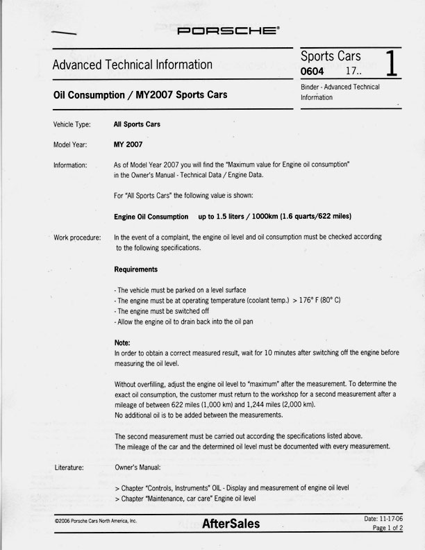

Assuming this is the same Gundo, where is he when we needed him? Gundo posted this for the MY2007 model and let me share. Pretty unreal as far as oil consumption. Has anyone checked the manuals that came with our cars? 1.6Qt/622 miles!!!! If my arithmetic is correct, Porsche allows about 391 miles/qt of oil consumption!!!

Old Aug 29, 2013 | 07:44 AM
  #41
Gundo's Avatar
Joined: Nov 2003
Posts: 426
From: Ridgefield, CT
Rep Power: 52
Gundo has much to be proud ofGundo has much to be proud ofGundo has much to be proud ofGundo has much to be proud ofGundo has much to be proud ofGundo has much to be proud ofGundo has much to be proud ofGundo has much to be proud ofGundo has much to be proud of
Yes, i did post that - i found it unreal as well. 1.5 liters per 1000 km or 1.6 qts per 622 miles.
At the time, my car, 2006 C2S with 10k ish miles was burning 1 qt per 1000 miles and I found it unacceptable.
Dealer reaction was to monitor, and every fill of oil had to be at their shop with a measurement before and after.
Net net, I was within tolerance. Made a big stink, they were ready to spend some money to diagnose my car, then PCNA - who reads these boards regularly - found the oil consumption survey I started and the many posts. My service agent casually mentioned that PCNA reads the boards, then denied my claim and the their offer of compression and leakdown tests for the oil consumption issue.
All of that is well behind me now, I still have the car, and I use about 1qt per 2k miles at this point. I do like the points about hard driving, as I definitely used more when taking to the track and driving hard. I currently 26k miles.
Good luck, but based on what I've seen, you are within spec and will see no help from PCNA nor your local dealer's service shop.
Gundo
Interesting,...I have always checked with the car idling,...never switched off?
Hmmmm. What does your manual say about this?

Originally Posted by Gpjli
Really? Let me be the first: RTFM wherein R= read and M=manual.
The manual for his 997.2 (2011 C4S) says check while idling. The Porsche bulletin from post #40 above was for 997.1. Here's what the 997.2 manual says:
Conditions for measuring the oil level
1. Vehicle stationary.
2. It is important to ensure that the vehicle is horizontal for correct oil level measurement to occur.
3. Engine must be at operating temperature (at least 140 °F/60 °C).
4. Engine must be idling.
