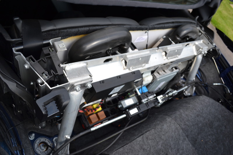

1 - Partially open the cabriolet hood until you can reach underneath the part below the rear window. From here unclip the 2 steel cables by gently pulling then towards the centre of the car.
2 - Next tilt rear window upwards towards the front of the car
3 - Remove the 2 plastic trim clips securing the carpet
4 - Gently free the carpet from the 2 fixed clips at each side of the hood (see Diagram)
5 - Now remove the carpet in the hood storage compartment completly
6 - With a trim removing tool - gently prise out the 2 plastic discs on the cross member above the rear seats. Now also remove the 2 pop up roll bar covers in the same manor.
7 - Remove the 3 phillips screws holding the cross member on. (one at each end and the one in the centre)
8 - Take off the panel and put to one side

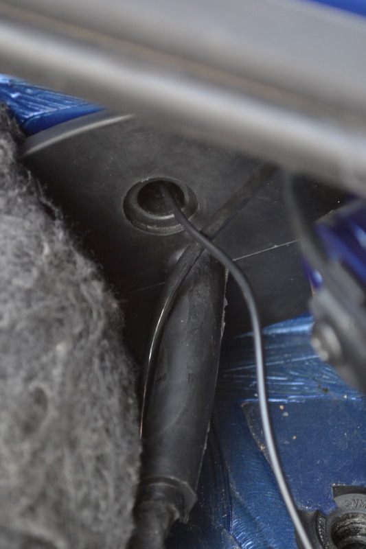

12 - On the passenger side (LHS) of the car - inside the roof storage compartment is a large square shaped rubber grommit. This already has a wiring loom running through it but above that is a spare harness hole with nothing in it. Using the trim removal tool gently prise this rubber grommit out which gives you access to both sides.

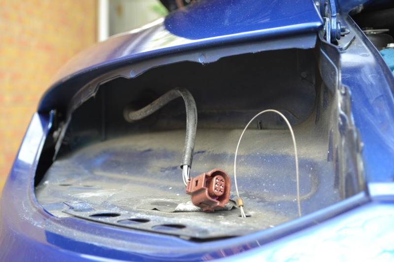

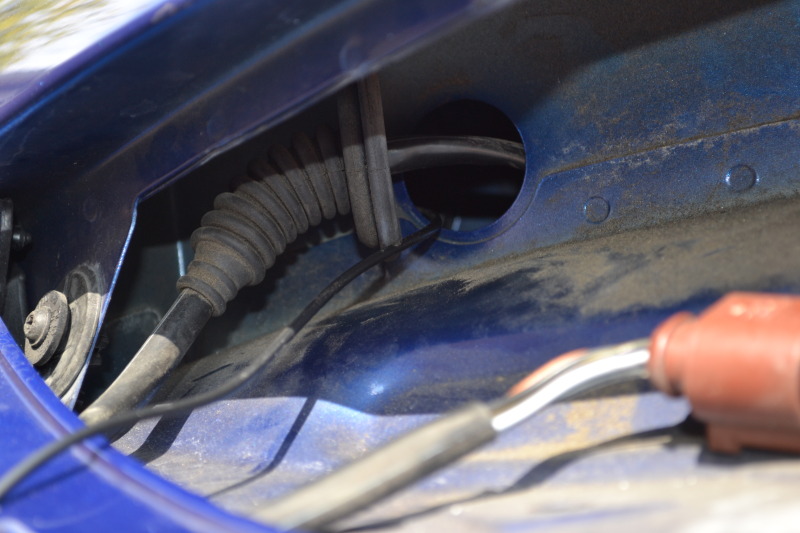

13 - Using a sharp screwdrive pierce a hole through the spare grommit channel and make enough room to feed 2 wires through.
From the rear of the car you will see a smaller wiring harness running up to a grommit - gently pull this grommit out and you will now have access to the whole where the larger grommit fits.

14 - Feed the RF CABLE through from the inside of the grommit - so that the spade connector has passed through the grommit and can be fed through to the whole where the rear light wiring harness sits.
15 - Feed the red 12V + wire through the grommit in the same way so that you now have 2 connections behind where the rear light would sit.
16 - Refit the large rubber grommit and ensure it correctly pushed into place.

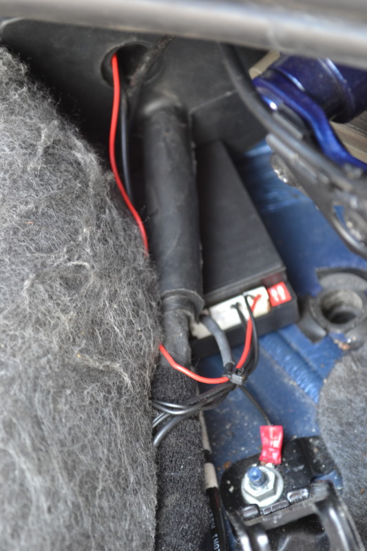

17 - Attach a ring connector to the black -ve wire of the PDC CONTROL UNIT. This can then be bolted down to the bolt shown in the picture using a 10mm socket

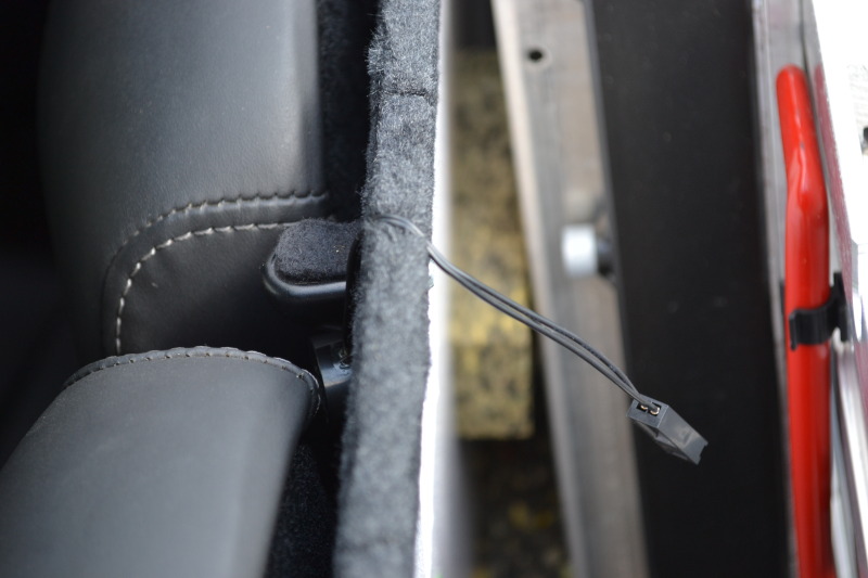

18 - Now route the BUZZER CABLE from the PDC CONTROL UNIT along one of the looms and up to the centre back of the rear seats (as shown)
19 - Attach the BUZZER and lay wire over the rear panel and allow to hang with a few cm of spare wire.
20 - Using some double sided tape secure the PDC CONTROL UNIT into place - I located mine in the corner of the hood storage compartment by the large rubber grommit (tucked under the large harness) See pics.

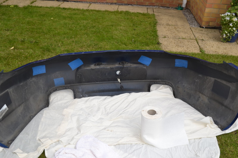

22 - With the rear bumper removed - Clean the inside of the bumper with some solvent cleaner to remove dirt and grease
23 - Once dry fit the ANTENNA SENSOR tape as per instruction - I started about 15cm from the edges of the bumper and ran the tape all the way around using the same line as the premarked PDC sensors on the inside of the bumper.
