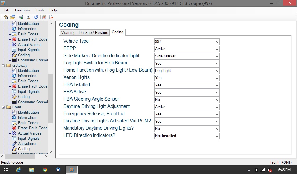

Coding via durametric or piwis to make side indicators blink when locking/unlocking
It seems there are cars that the side indicator lamps blink when locking and unlocking and some that dont. Apparently then this is a coding thing. For those with durametric pros or piwis, can you help in the procedure to make the indicators blink. Or is it only possible when the indicators are set only as turn signals or park lights? Hope we can get advice from our technical brothers

Hi jh, For the 997.2 they could both. Side markers are now working as running lights and signal lights. When car starts the side markers are already on, so they are running with the front drls. But, when the turn signals are activated, the side indicators blink with the front and rear signal lights. Its a very nice feature. But now the side indicators do not blink when locking and unlocking which, if i recall correctly did so before when they functioned just as signal lights, i am hoping they could still be made to function as locking and locking indicators.

Just played with the settings on my 997.1
Front Module
Option 1
Side Marker / Direction Indicator Light: Side Marker
Side markers do not flash when vehicle locked or unlocked
Option 2
Side Marker / Direction Indicator Light: Direction Indicator Light
Side markers do flash when vehicle locked or unlocked
With Durametric the side markers can only be set as side marker or direction indicators, not both, at least on 997.1. I looked through the other modules and cannot see anything else that would appear to effect the side markers function. Nor could I see anything to make the horn beep when the alarm is set or unset.
