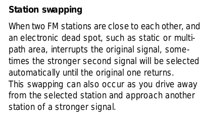

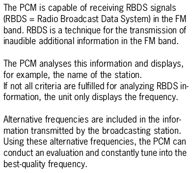

You guys may be experiencing either of two different problems, one of which is solvable.
First, Porsche acknowledges that stations may swap when two stations are close to each other, and one station is stronger. There isn't anything you can do about that. (See the PCM 2.1 Owners manual, page 99

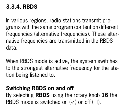

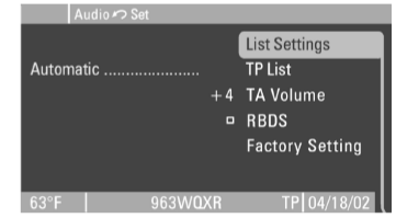

Second, there is an RBDS Feature which is used to display station information, song data, etc. Apparently, RBDS also can specify alternate frequencies, and PCM uses that to automatically tune your radio station to receive the best quality signal. (See the PCM 2.1 Owners manual, page 19).
You can disable RBDS as follows (See the PCM 2.1 Owners manual, page 30)...
