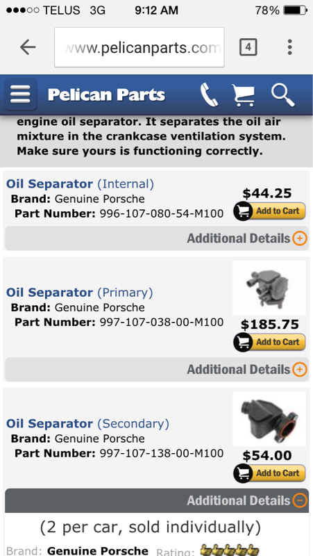

which parts did you get?
their is a few aos?? I am doing ipd and plenum mod so might as well do the aos but wondering what to buy. its 08c2s

Interesting. I never knew about the secondary one. The one that broke and I replaced was the primary one.

My 08 4S uses Porsche PN 997 107 038 00. Suncoast parts or your favorite supplier.
