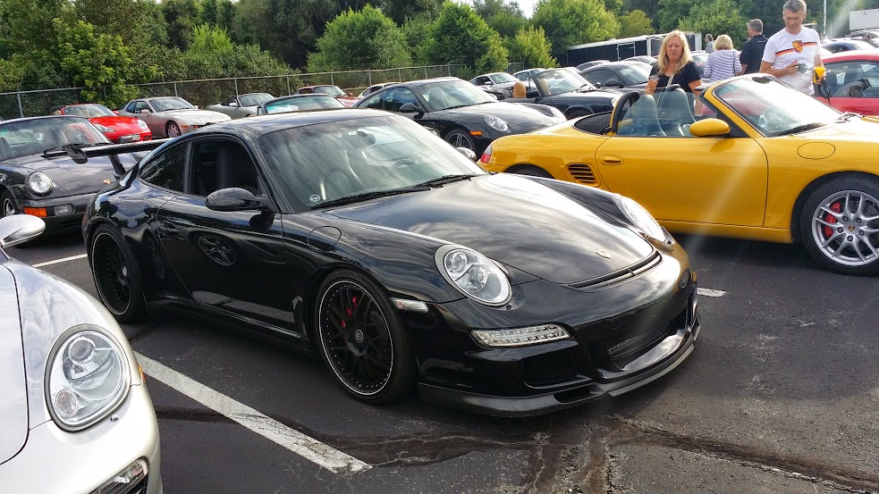

It depends on the tires, my 20"s with PS2 is a lot smoother and quieter than my 19"s on Nittos. My 20"s is also lighter than the OEM wheels. Looks great with 20"s, get the lightest wheels you can afford, wrapped in Michellin PSS and you'll be fine with the rid3.
