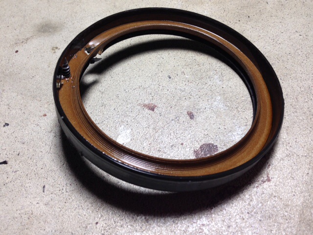

Finally got the RMS installed. I am not going to touch the IMS after some research I think the IMS seal is ok. Here is the picture of the old RMS SEAL. It's a thin seal with aluminum sheet inside.
