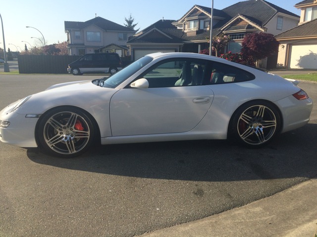

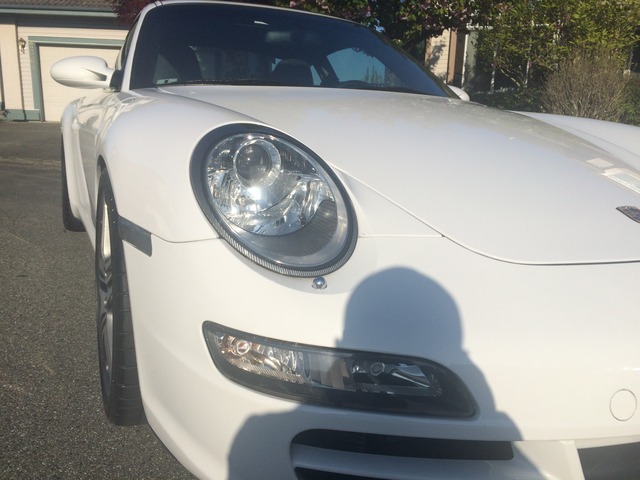

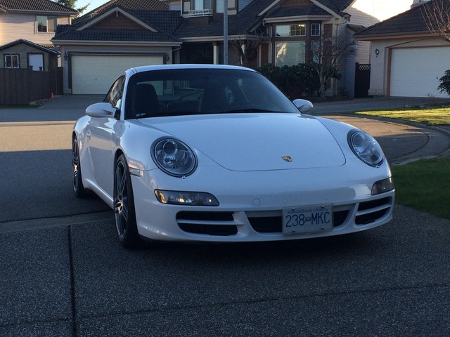

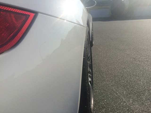

Here are some pics of the NB Turbo style wheels with 15mm spacers front and rear. So 57/67 offsets becomes 42/52. Dropped on Bilstein coilovers with more aggressive camber front and rear than stock. Michelin Super Sports (235/295).
