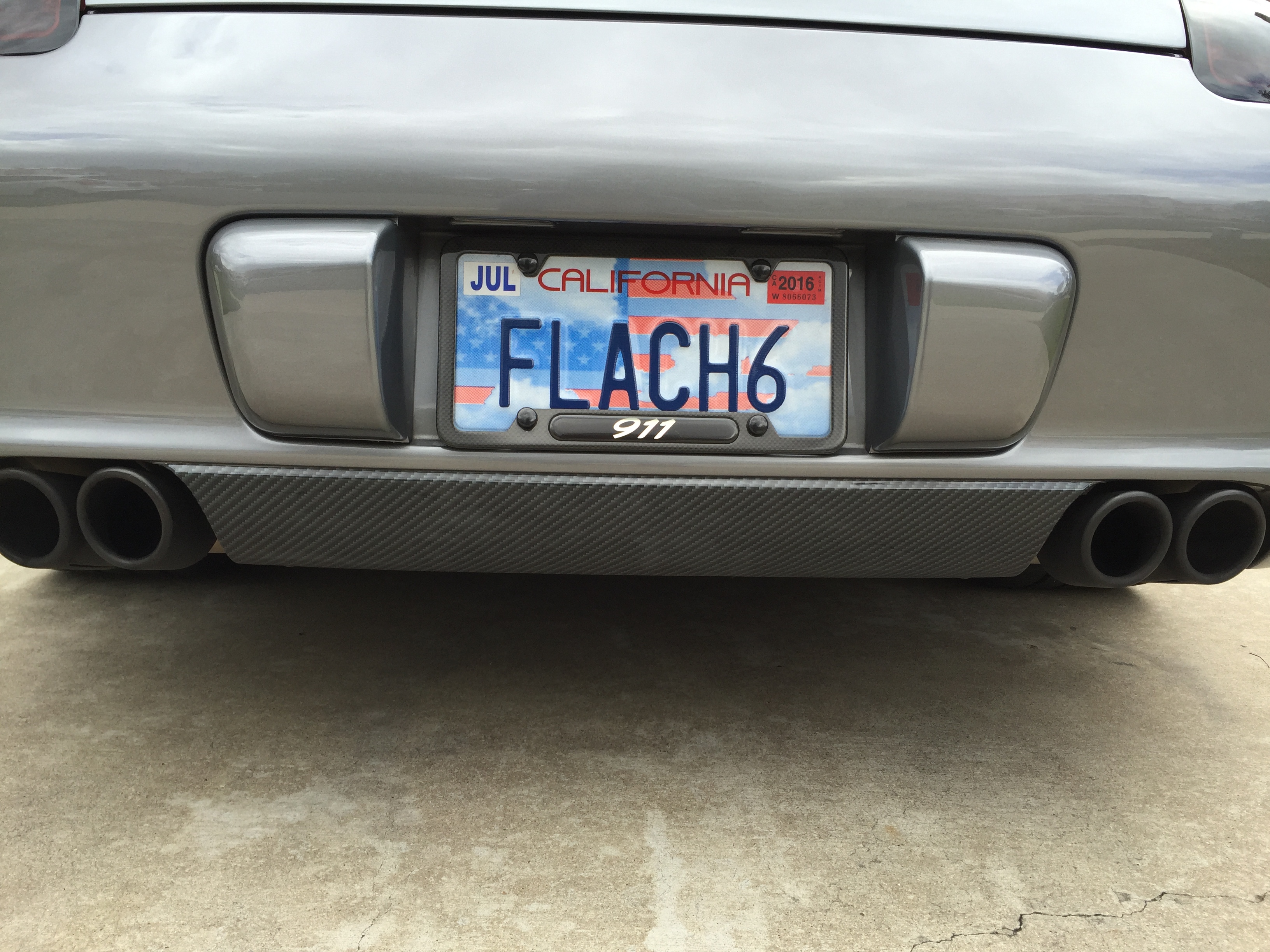

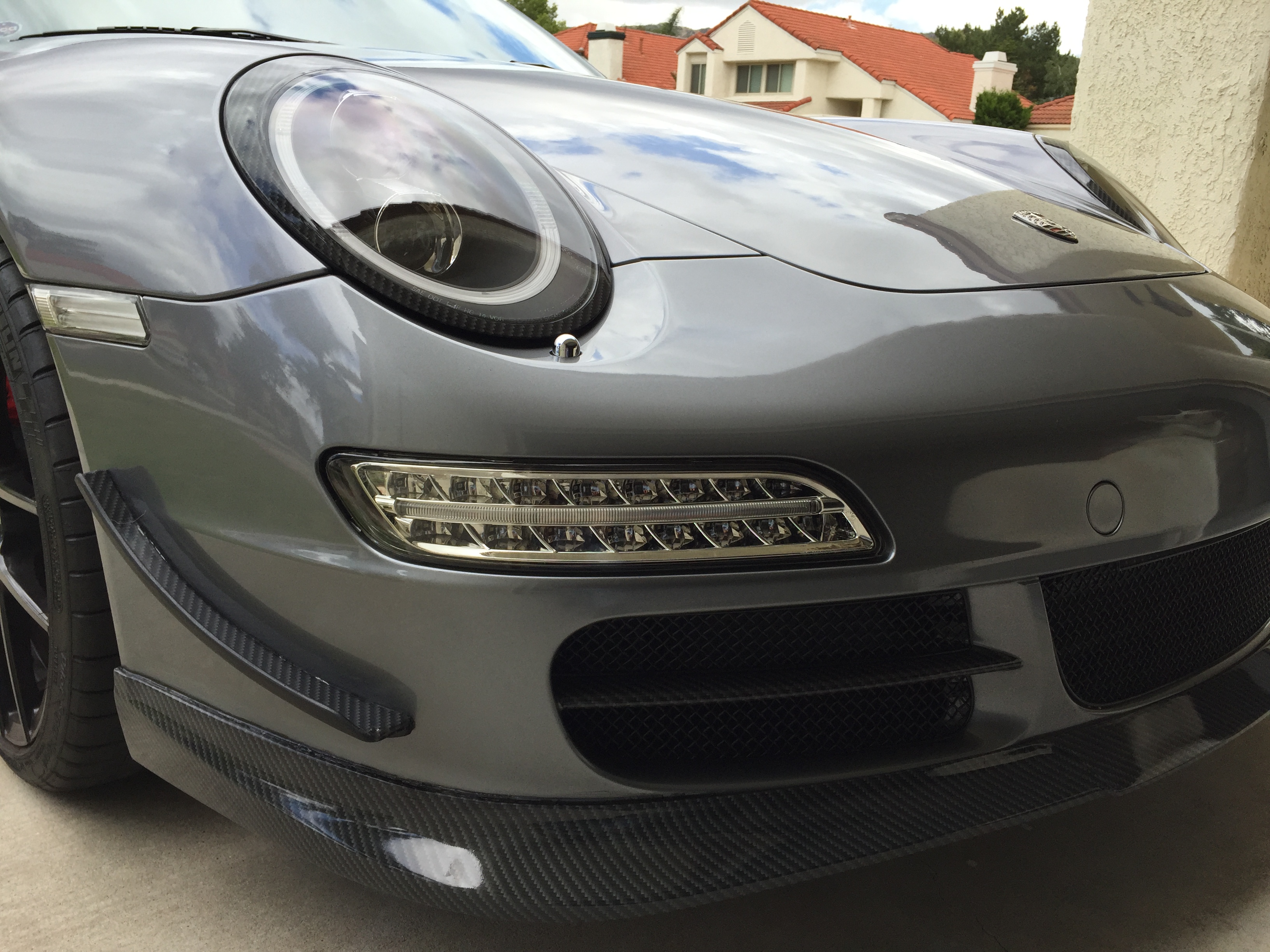

Old Jun 24, 2016 | 04:23 PM
  #42
SoCal C2S's Avatar
Joined: Aug 2014
Posts: 175
From: Simi Valley, CA
SoCal C2S is infamous around these parts
I did this CF wrap about a month ago....did the spoiler, dive planes, headlamp ring, diffuser, and roof.

Old Jun 28, 2016 | 01:41 PM
  #45
SoCal C2S's Avatar
Joined: Aug 2014
Posts: 175
SoCal, you did a good job with your car, looks good! Do you have a rear diffuser? Did you wrap that too?[/QUOTE]
Just wrapped the section between the tailpipes.
