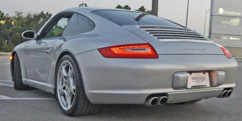

997S, H&R springs, 5mm spacer front, 15mm spacers rear, not lobster forks- but same sizes, 235 front, 295 rear. PERFECT, no rubbing.

Car looks good would it rub with 305's? Also what spacers are you on?

I am on ECS Tuning spacers. Love them, I used ECS spacers on my M3 prior. They are model specific hub centric, so perfect fit, no vibration and you can order as a set with extended lug bolts.
As for running 305's, can't speak from personal experience, if on oem rear wheel specs (19x11, et 67), there should be room for 305's w. a max 15mm spacer. Anything beyond this, and you will most likely rub.
I personally think that running 305's in the rear, while running 235's in the front is too much discrepancy visually and performance-wise (understeer). If you do, run 245's in the front.
