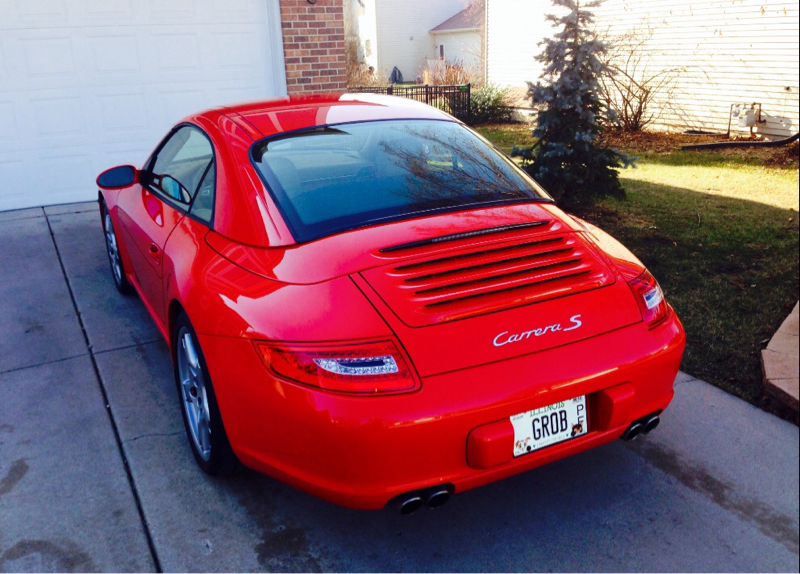

Make sure the rear bolts are adjusted correctly, if too low they can scratch your paint, if too high it leaves too much play on the hard top causing it to move as the car flexes (yes, they do flex) which can be the cause of your noises.

It's not only the torque, there's also a couple of bolts that adjust the height from the hardtop for the actual body of the car, that is the one that you have to be careful with, if you are too low it will make contact with your paint, they are sort of "the limiter" as too how close your hardtop gets to your car, Beautiful looking car!!.
