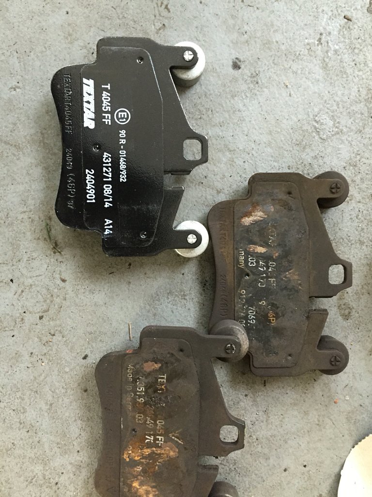

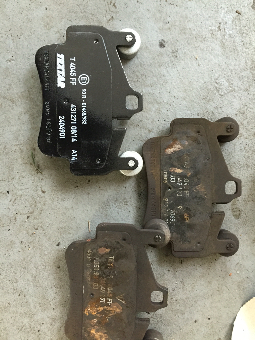

Great write up!! Just on a side note, others may want to consider "Tektar" pads as they are the makers for OEM Porsche stamped pads. They are typically quite a bit less than OEM, and are OEM. iirc, front Tektar pads were like $120 bucks for the set.
I also like to use OEM rotors over the other offerings.

Porsche pads (old) next to Textar OEM
