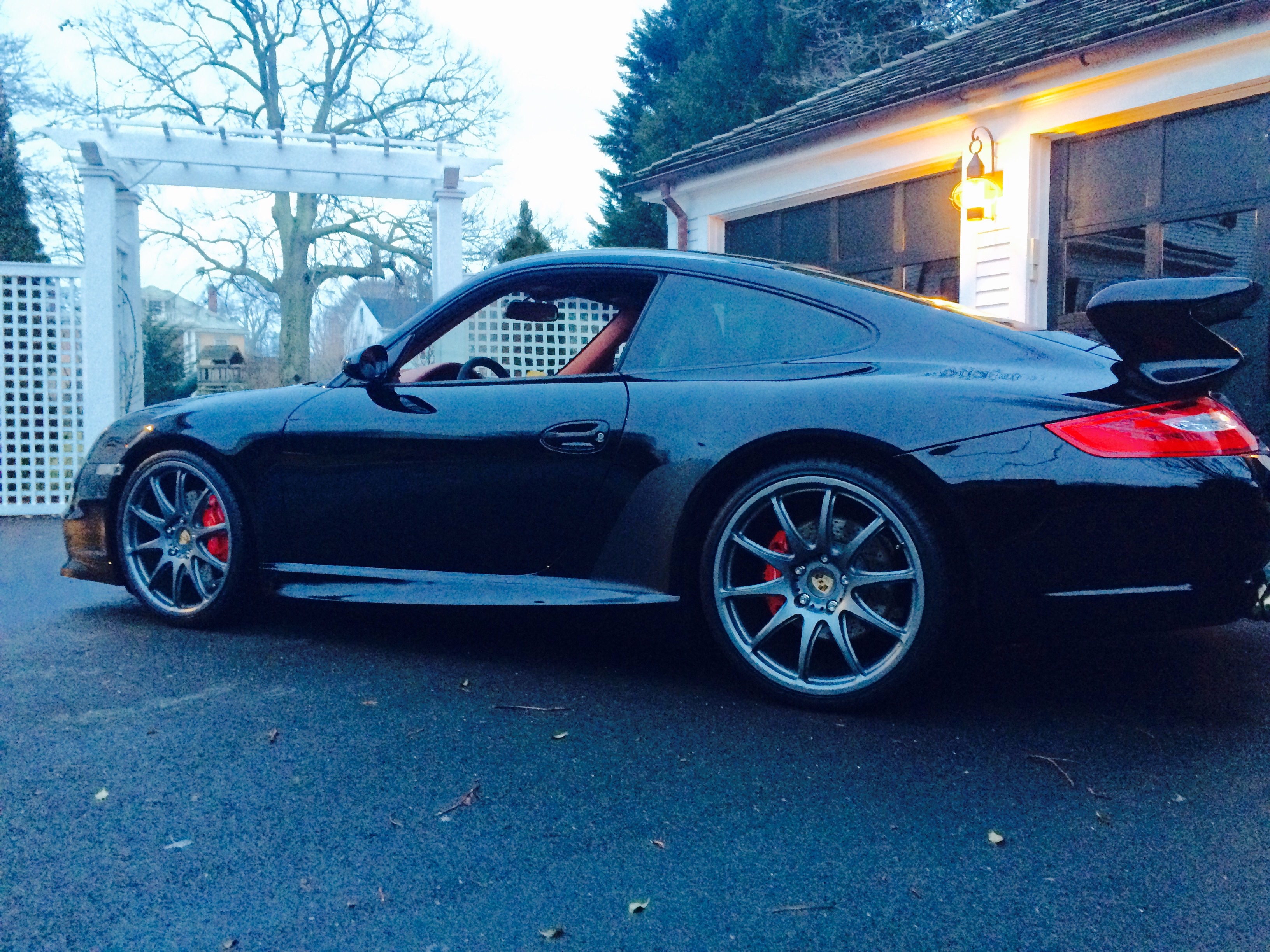

On a 997 I would say 19". The 991 seems to accommodate 20" a bit better if you ask me, but that's just my personal take on it.
HRE P104's in Brushed Titanium - 19"

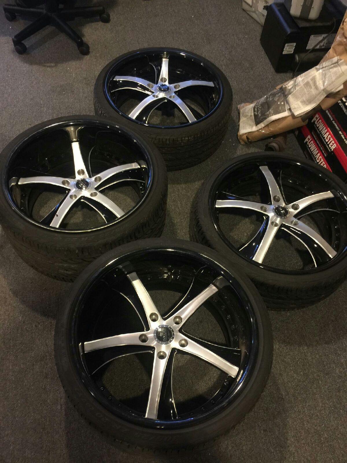

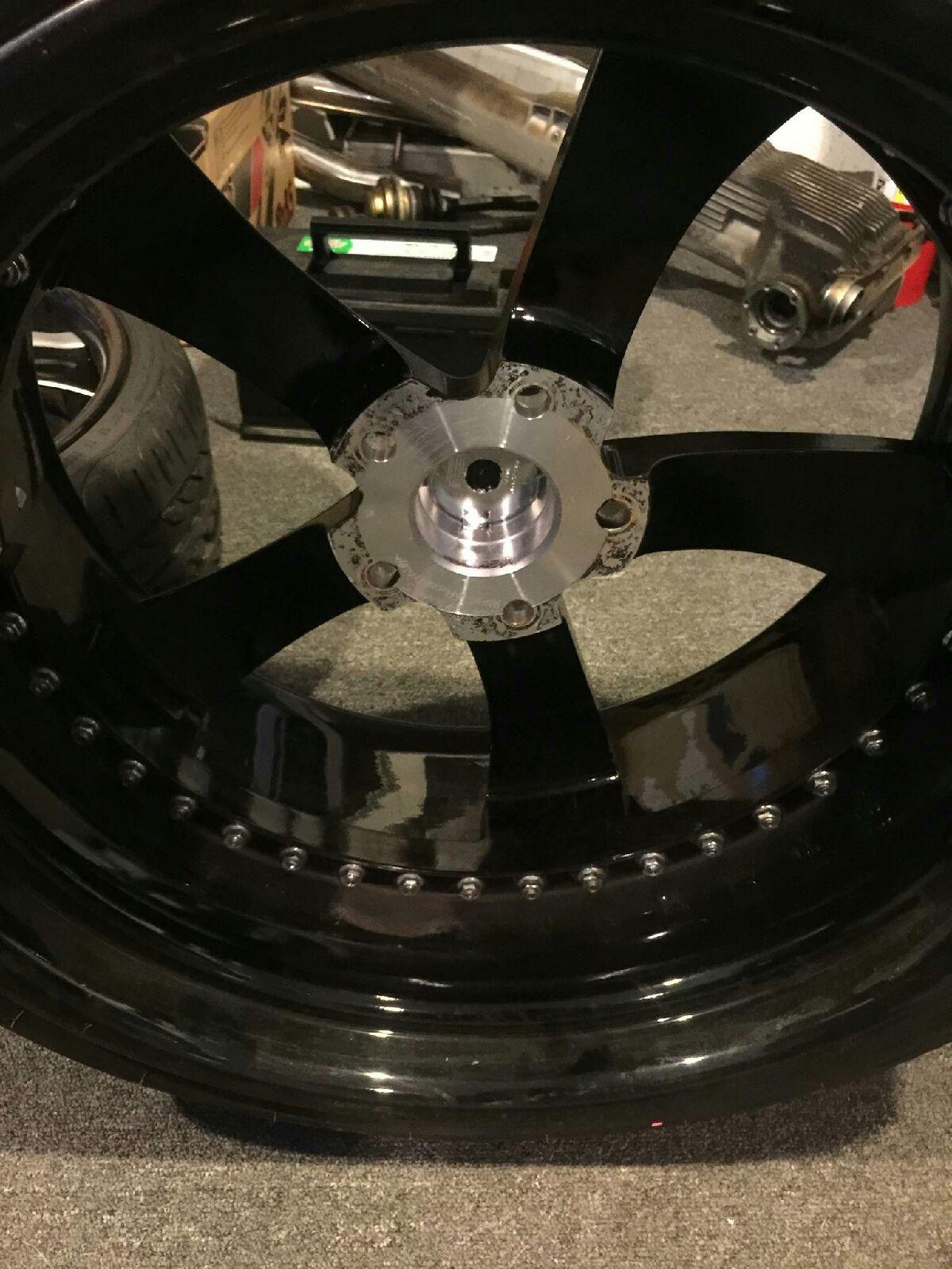

if something like this would intersted you my buddy is practiclaly giving these away. 20" 8.5 and 11" with new pirelli rubber. less than 100 miles on the set. perfect in every way. 996 turbo offsets
