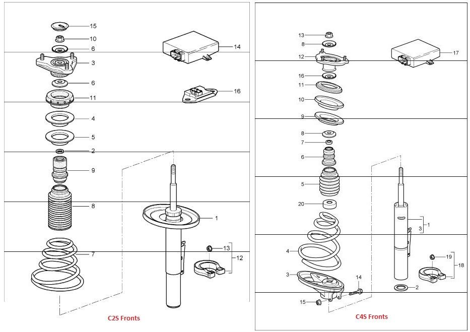

Just check the PET manuals briefly. In stock form the fronts are very different between 2S and 4S, with not a lot of common components. But the rears share a bunch of parts coupe to coupe, cab to cab, including the rear shocks 997.333.053.25 and top mounts 997.333.061.01. Rear springs are different though.
Based on this I would expect 2WD coilovers to fit a 4WD in the rear only, ignoring spring rate differences.
Fronts diagram below (left is 2WD, right is 4WD)

the rear is the same, the front on the other hand
the 4wd drop links connect to the strut
the 2wd drop links connect to the knuckle
it is very different
