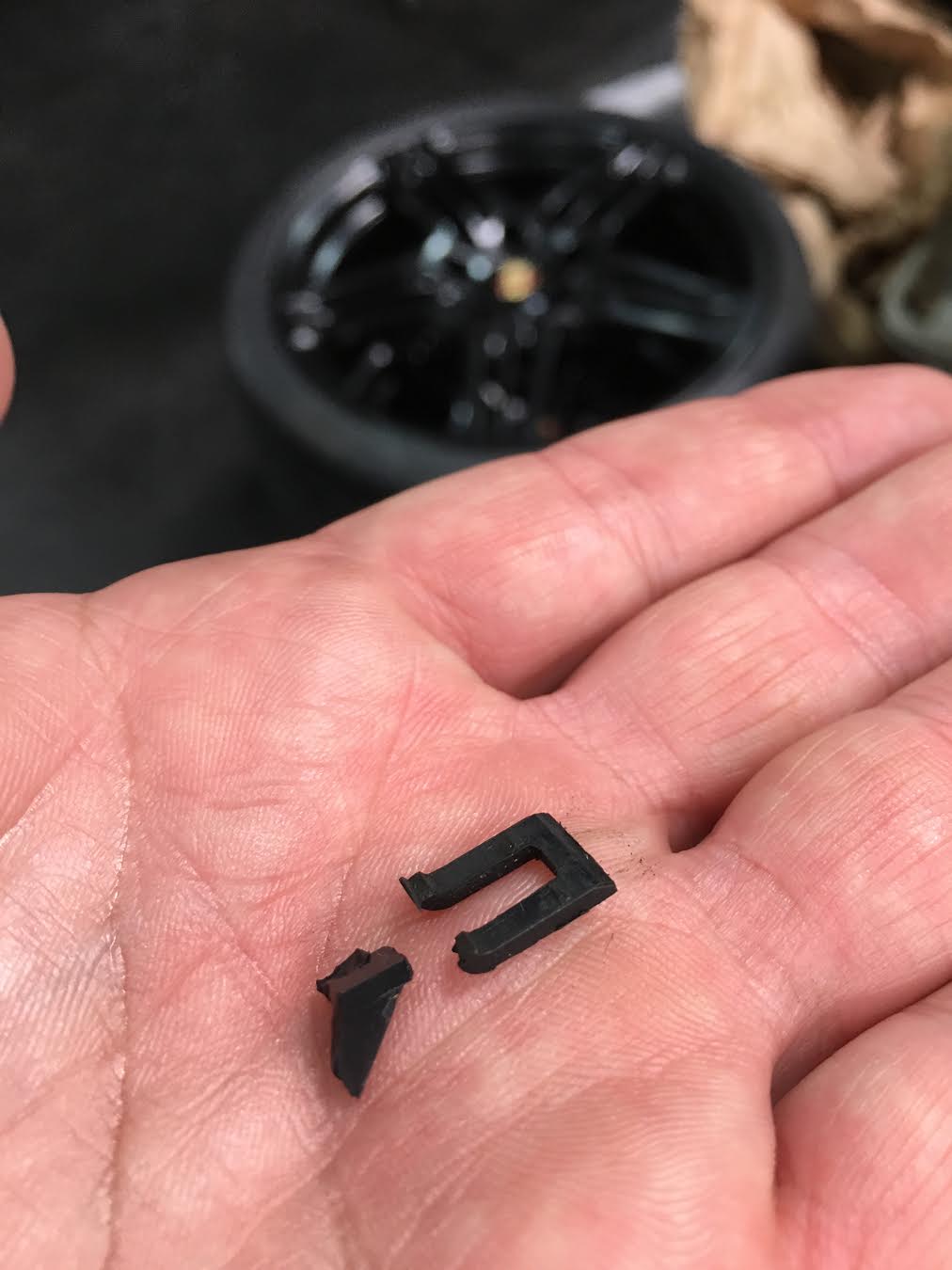

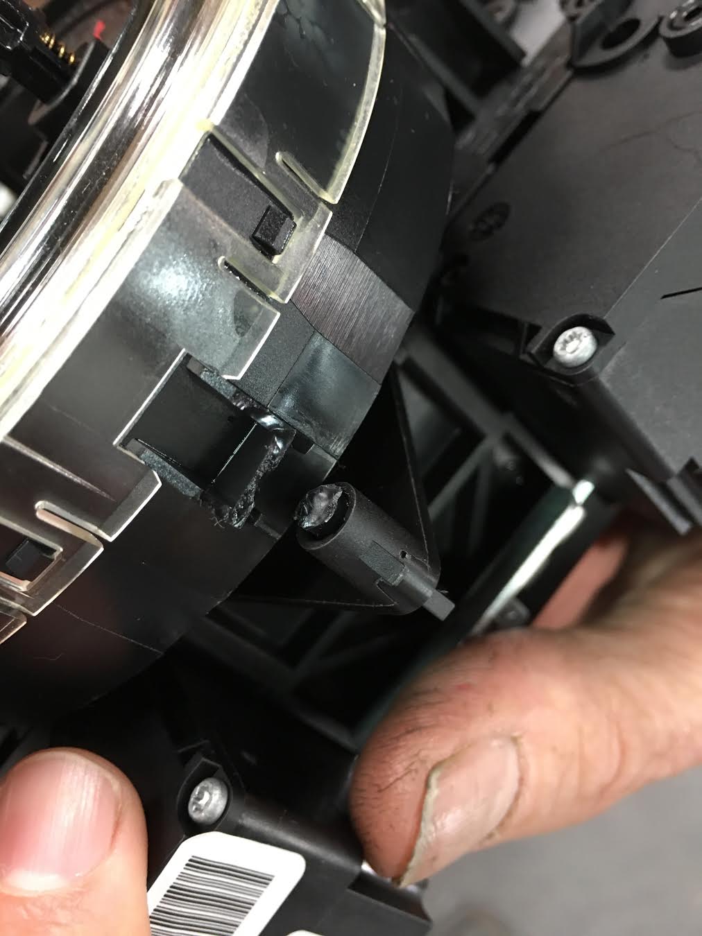

Gateway replaced - no joy.
Steering column examined an a few broken pieces found - hopefully the fault has been found. Replacements on the way.
ID:	475040   Click image for larger version
Name:	broken piece 1.jpg
